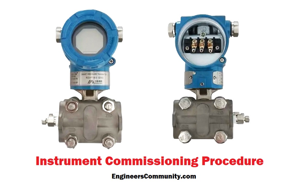

Instrument Commissioning procedures entail all the activities required to validate and verify that all the instruments are installed correctly, safely, and can be operated as per their design intent.
Instrument Commissioning Steps
Here is a general step-by-step procedure of instrument commissioning:
