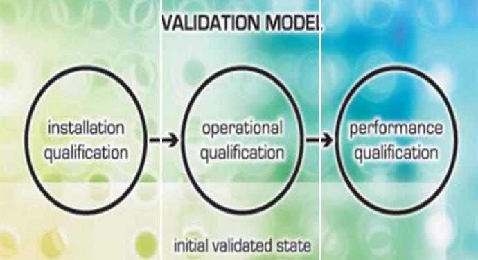

Three validation principles – IQ, OQ, PQ
IQ- Installation Qualification
Installation qualification verifies that the equipment and its subsystems have been installed in accordance to manufacturer’s specifications.
Usually performed by the company’s field representative.
Examples:
  • Verification that all components parts are functional
  • Verification that local supply voltages conform to instrument
  • Verify that the ambient conditions exist for optimal instrument performance.
  • Verify correct versions of software were issued with the instrument.
  • Setting up of instrument parameters (date, time, language, test protoc.
OQ- Operation Qualification
This validation provides evidence that the instrument operates as expected and confirms that installation was successful.
Done by the field representative and lab technicians.
  • Training of instrument operation.
  • Testing of controls, calibrators and a few patient samples.
