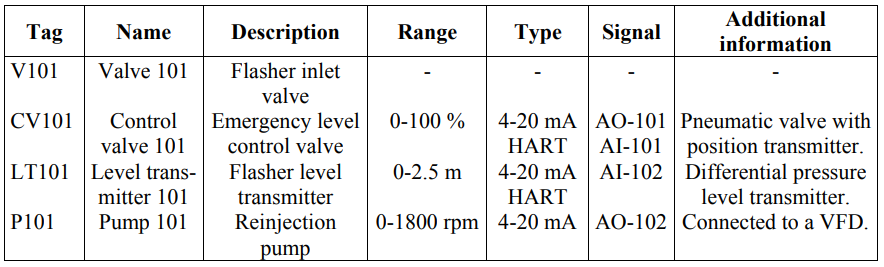

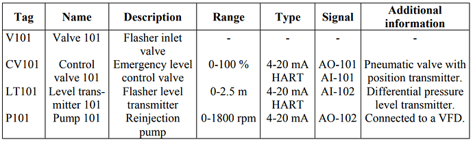

An example of an instrumentation list using the flasher level control example is shown in Table 1.
TABLE 1: Instrumentation list for a flasher level control
