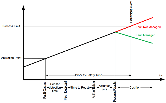

How much time the interlock system has to respond depends on the process dynamics and the
conditions initiating its actions. The process safety time available for any given safeguard starts when it
is required to take action and ends at the point where the event can no longer be mitigated.
The process safety time is defined as the time period between a failure occurring in the process or the
basic process control system (with the potential to give rise to a hazardous event) and the occurrence
of the hazardous event if the safety instrumented function is not performed.
Given the degree of uncertainty in the process safety time, the interlock system should be capable of
completing its action within one-half of its allocated process safety time.
The time to react is defined for each interlock function. It determines the techniques to be used for the
implementation of the function. The time to react is the time elapsed between the risk materialization
and the request for mitigating action is issued.
