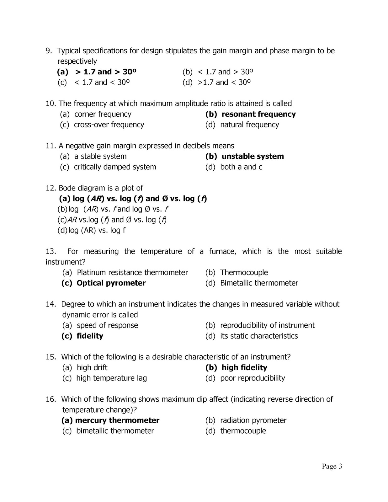

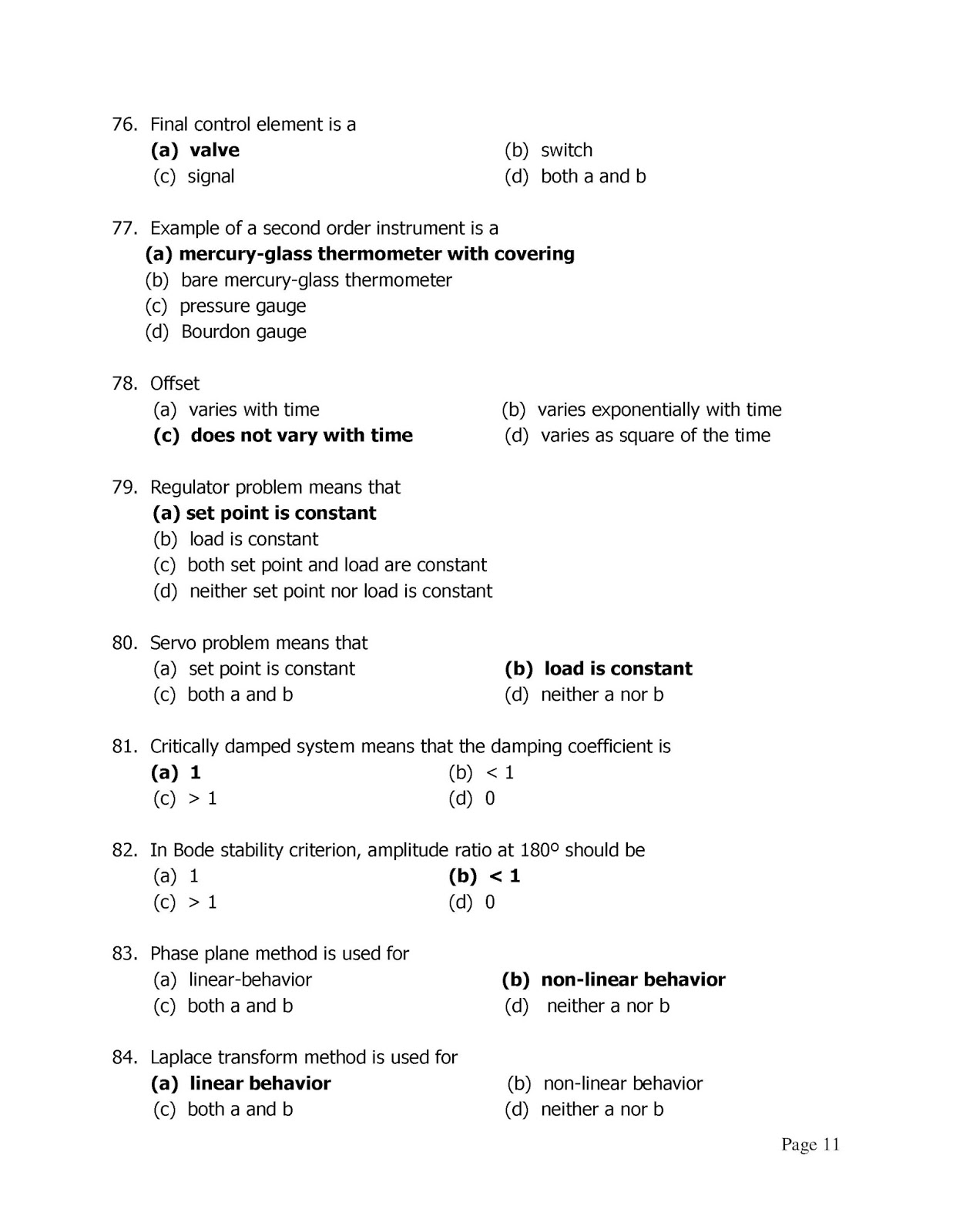

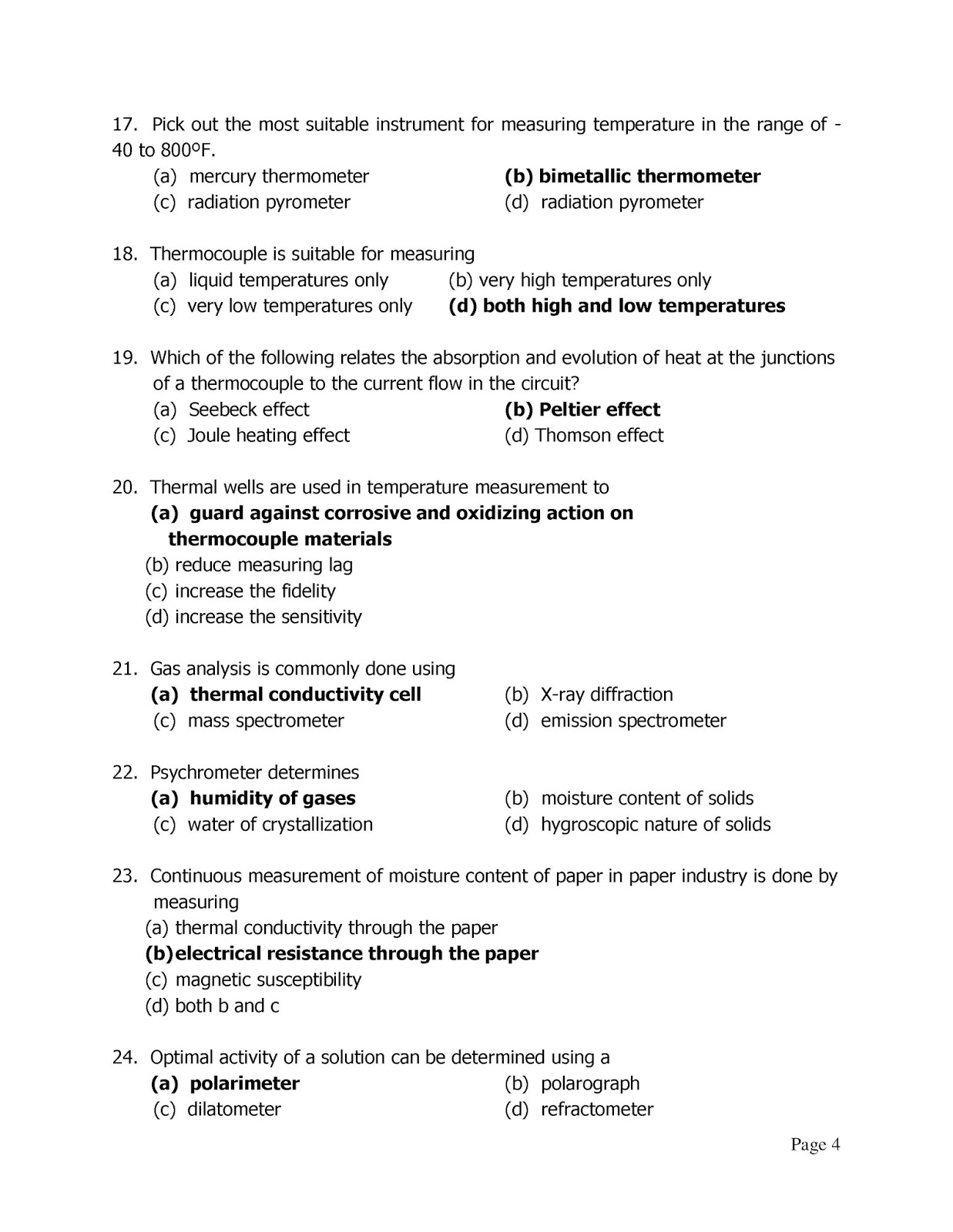

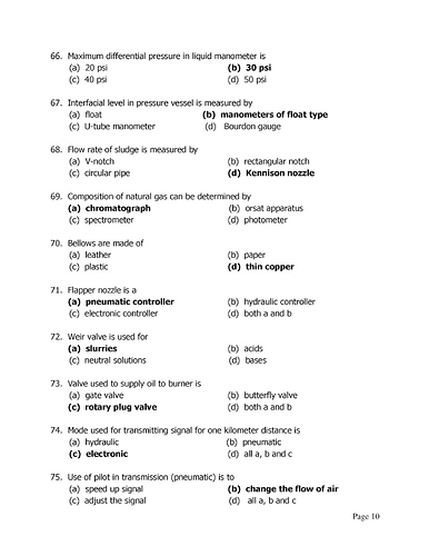

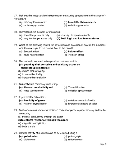

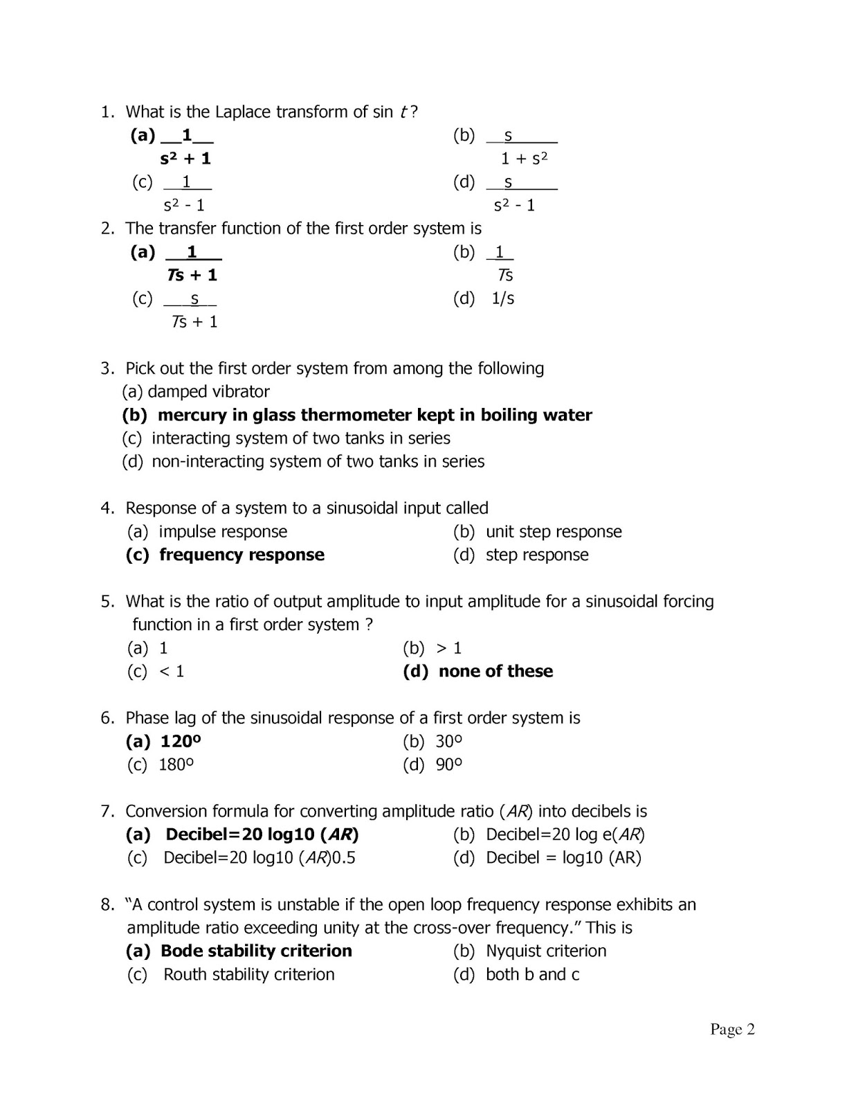

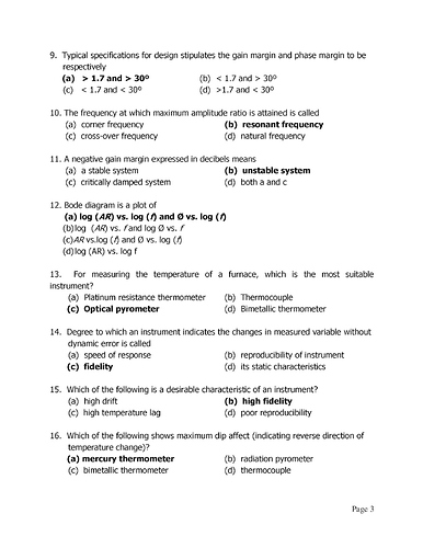

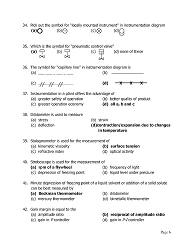

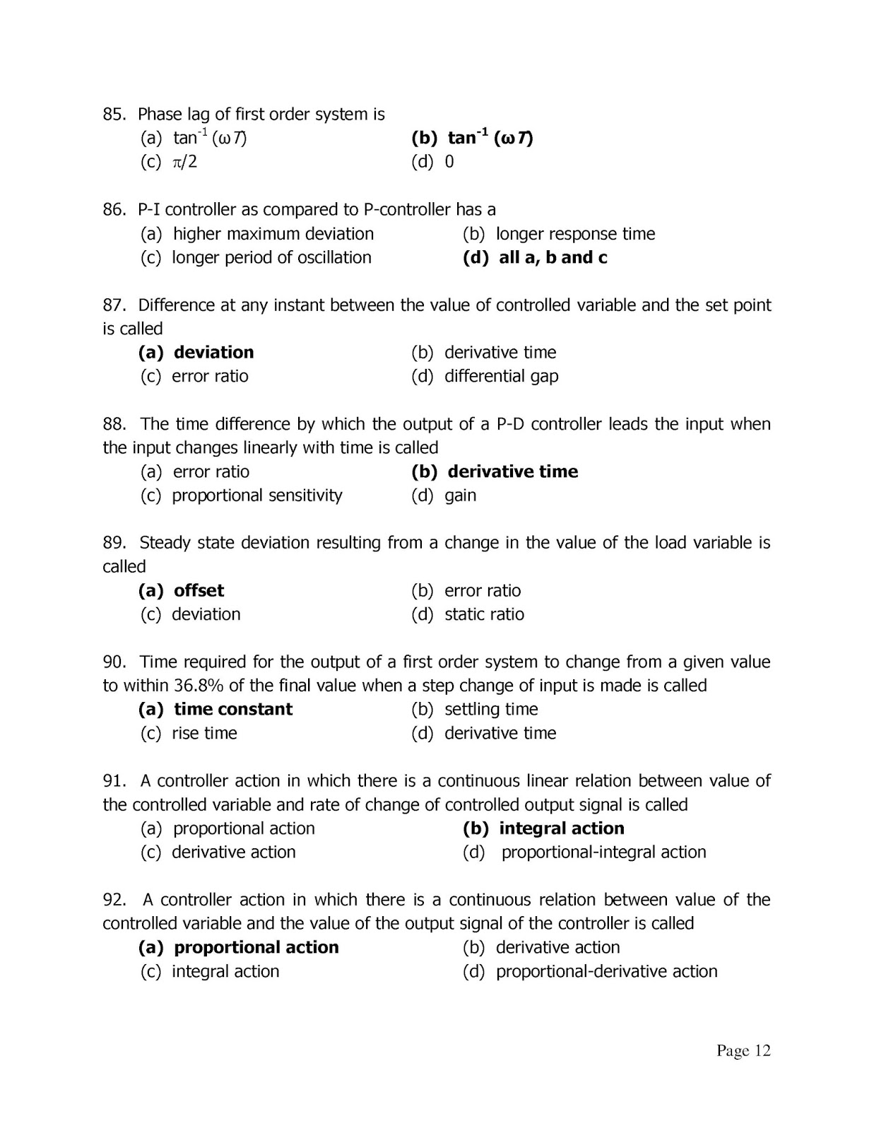

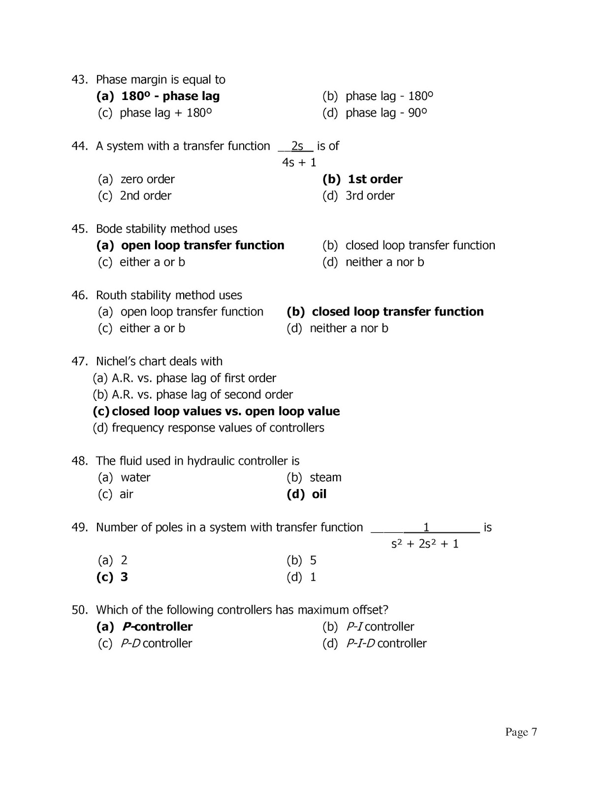

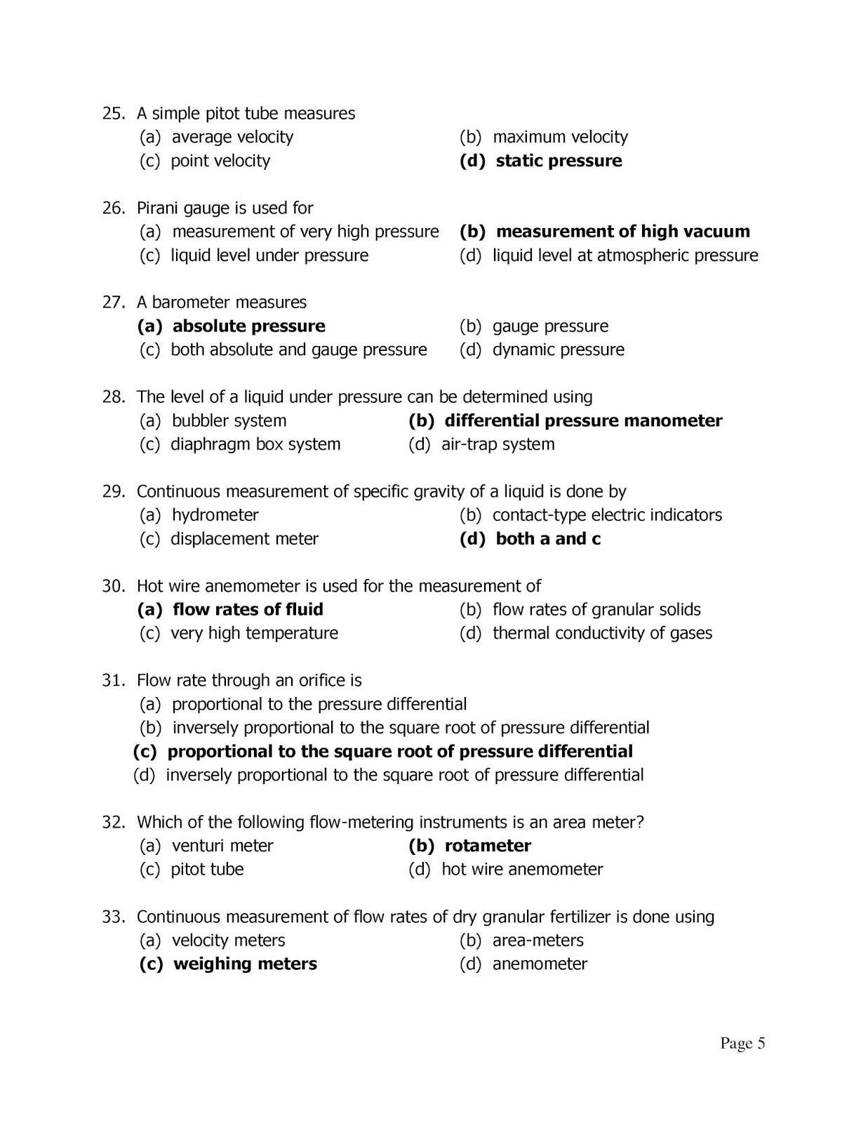

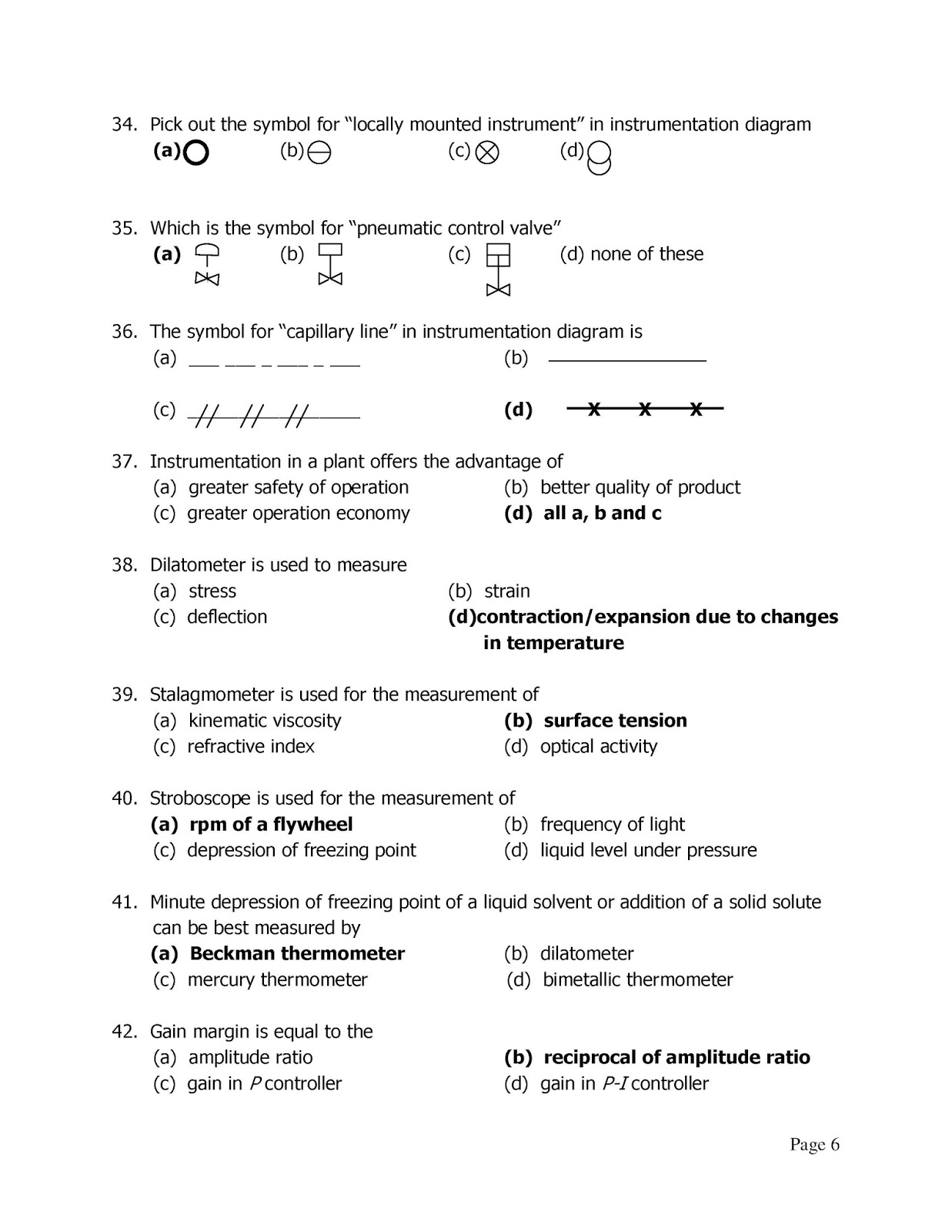

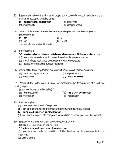

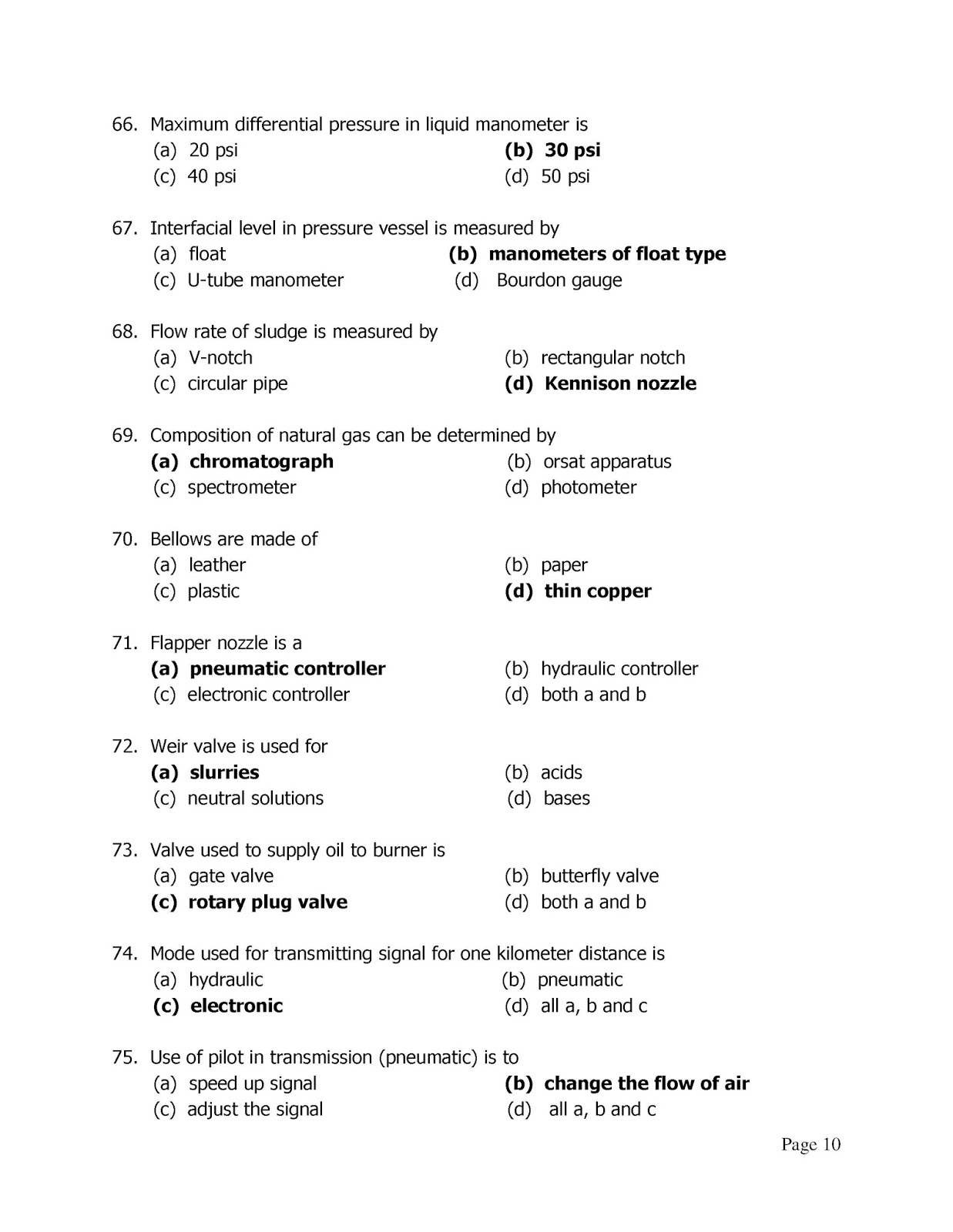

Interview preparation for instrumentation
this section deals with Interview questions.
This will help you to prepare for PSU’s.
1237×1600 203 KB
1237×1600 231 KB
1237×1600 237 KB
1237×1600 243 KB
1237×1600 206 KB
1237×1600 166 KB
