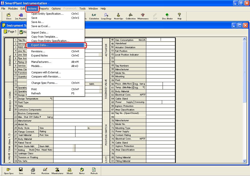

Exporting specification sheet (creating .isf files) – by Intools operator
- Open instrument specification for the specified tag number
- Select “Action” >> “Export Data…”
- You will be prompted the location and file name to be saved. Ensure the file type is Intools Spec Files (*.isf)

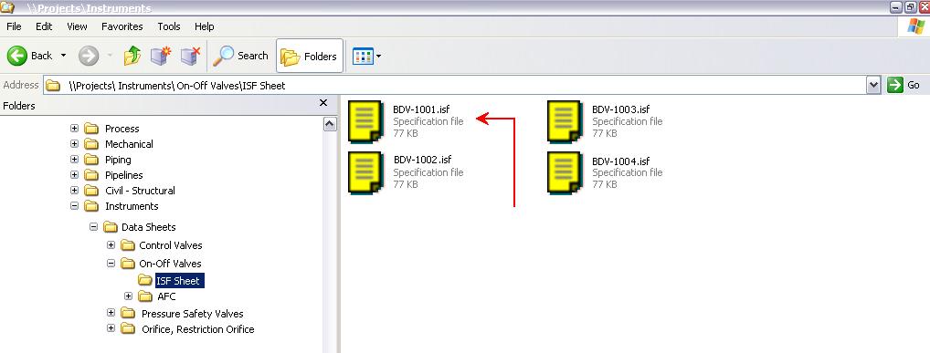

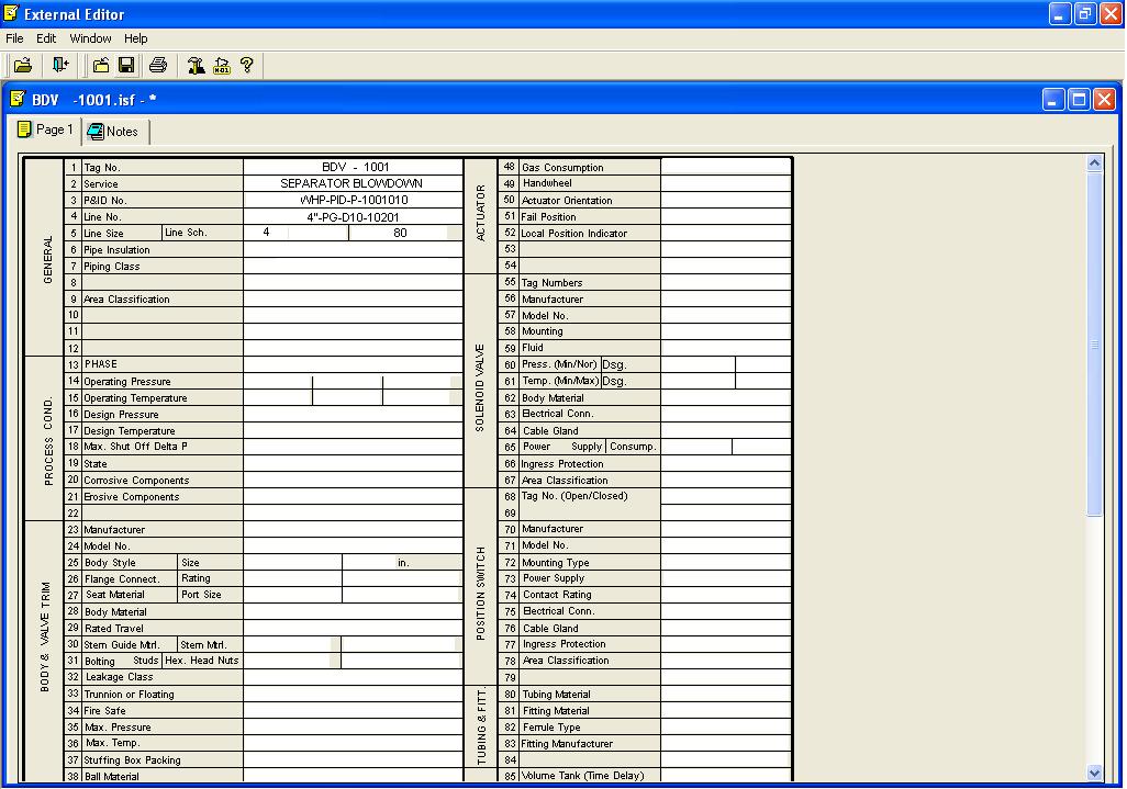

Filling detail data in specification sheet using Intools – by Instrument engineer
Open windows explorer and go to location where the files are saved. If the Intools external editor has been installed, the file will be readable.
Open the the file and fill the data sheet as necessary, and do not forget to save once finished.

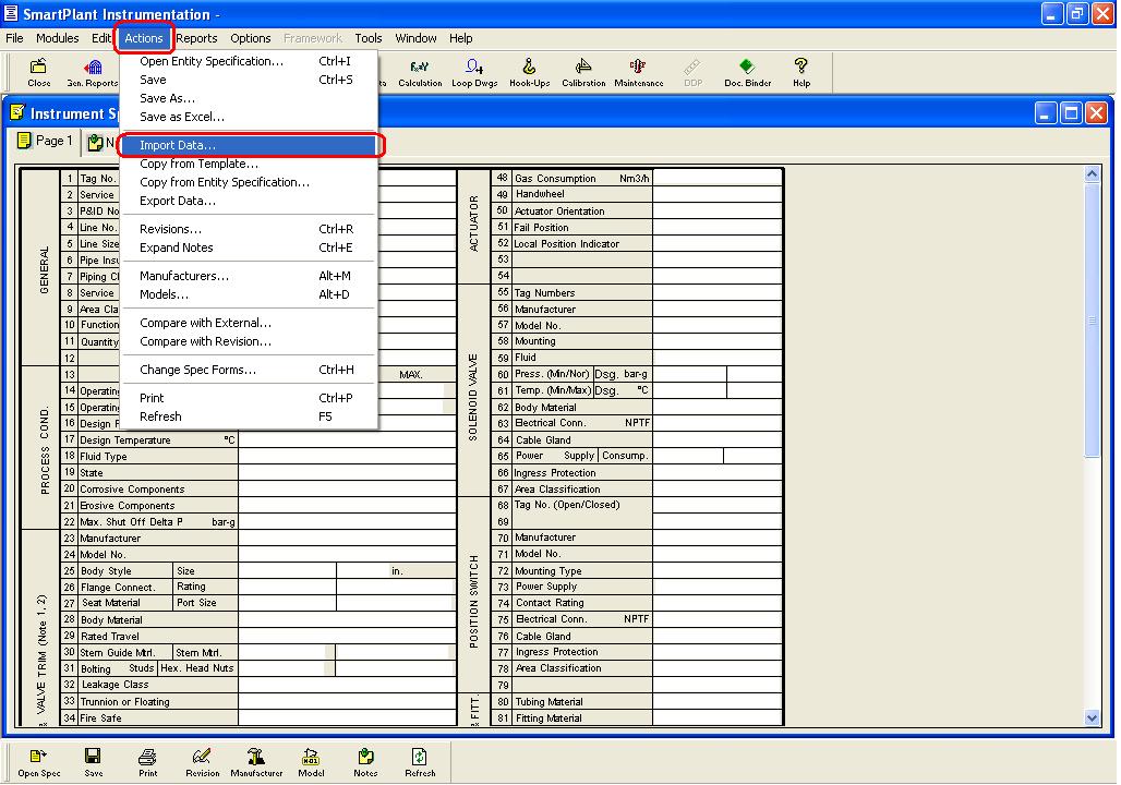

Importing specification sheet – by Intools operator
Select “Action” >> “Import Data…”
You will be prompted the source file to be imported. Note: The tag number should match otherwise it will fail to import.
Wait for a moment since Intools progressing importing the data.
