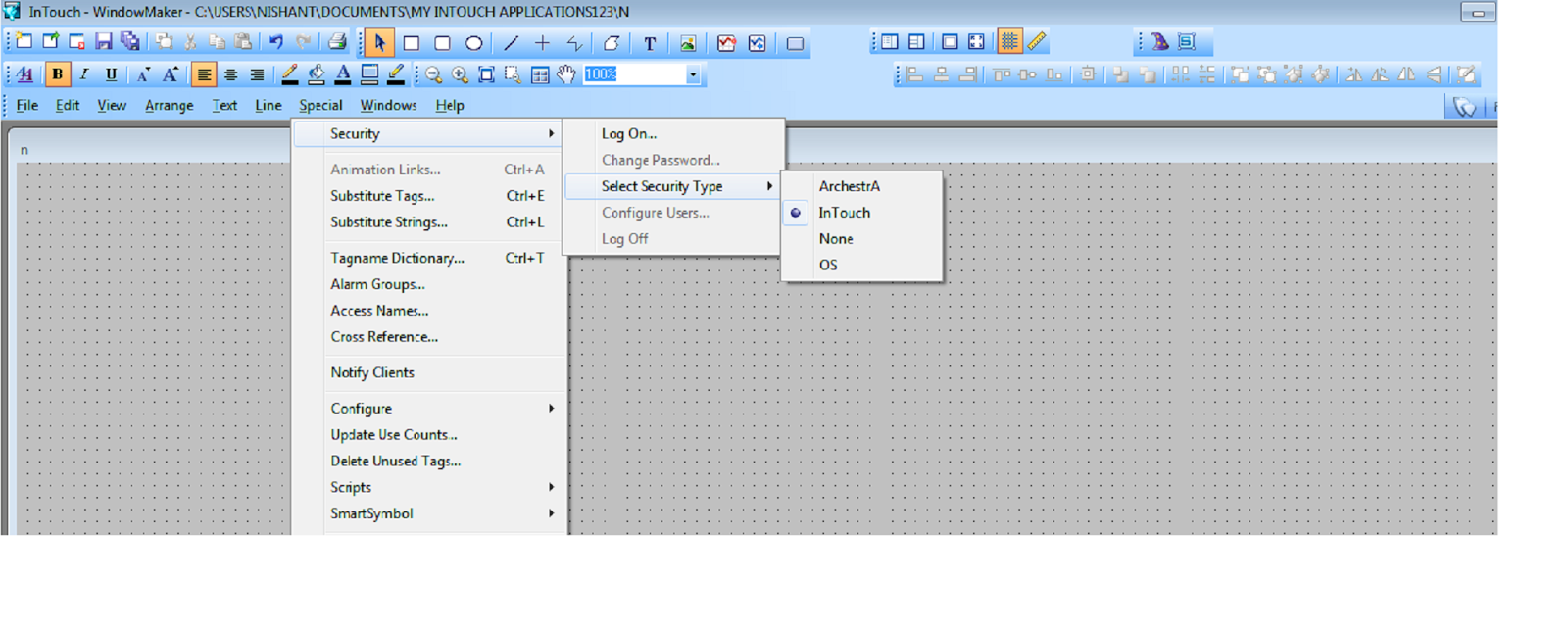

Click on special then click on security then select security type InTouch as shown in figure.
Then again click on security then click on LOGON,you will see this.
For wonderware software the name is “administrator” and the password is “wonderware” .
