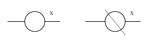

The first is a normal output, when energized the output will turn on, and energize an output.
The circle with a diagonal line through is a normally on output. When energized the output will turn off. This type of output is not available on all PLC types.

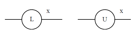

The L (latch) and U (unlatch) instructions can be used to lock outputs on. When an L output is energized the output will turn on indefinitely, even when the output coil is deenergized.
The output can only be turned off using a U output.

Output Instruction
When power is applied (on) the output x is activated for the left output, but turned off for the output on the right.

Latch and Unlatch
When the L coil is energized, x will be toggled on, it will stay on until the U coil is energized. This is like a flip-flop and stays set even when the PLC is turned off.
