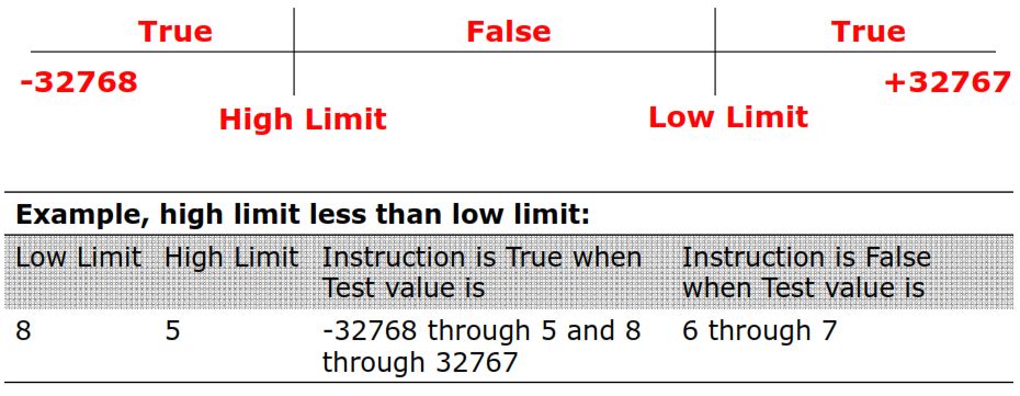

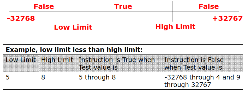

If the Low Limit has a value equal to or less than the High Limit, the instruction is true when the Test value is between the limits or is equal to either limit.
If the Low Limit has a value greater than the High Limit, the instruction is false when the Test value is between the limits.
