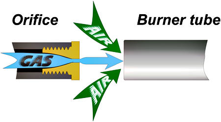

The gas orifice dispenses fuel into the combustion or burner tube through a small, high precision hole. The orifice delivers just the right amount of fuel to mix with the correct amount of air, to create just the right flame for the job in your appliance.
If you change the size of this orifice either larger or smaller it can alter the operating characteristics of the appliance, maybe even with a disastrous outcome to life or property.

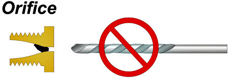

Cleaning a blocked orifice
When cleaning a blocked orifice, it is important that you do not make the hole any larger! Be gentle, and follow the instructions below.
- Soak the orifice in alcohol.
- Use an air hose with a high pressure nozzle to blow it out.
- As a last resort, use a tooth pick or the bristles of a tooth brush to clean it.
Never use a drill bit, dental pick, Oxy-acetylene tip cleaner, or any other metal object to clean the orifice!
