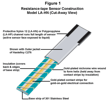

The reason for Metritape’s success is its simple principle of operation and the high quality materials used in its construction. The sensor consists of a gold plated, stainless steel base strip, partially insulated from a gold plated wire that is wound around the base strip to form a helix (figure 1).
This helix is sheathed in either Mylar or HastelloyTM to insulate the sensor’s inner elements from the liquid to be measured. Sliding the sheathed helix into a protective channel that leaves the front of the sensor exposed then completes the sensor. The sensor is generally contained within a still pipe suspended from the top of the tank. However, other mounting options are available.
When the sensor is installed (figure 2), the outer envelope jacket (1) is compressed by the hydrostatic pressure of the liquid (2). This causes the gold wire winding to contact the gold plated base strip. The resulting change in the resistance of the gold wire (3) indicates the length of active helix and the distance from sensor top to liquid surface.
