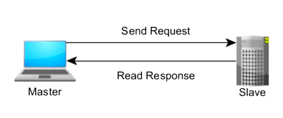

Modbus Protocol
Modbus is a master/slave or client/server protocol. It means that one device, the master (usually a computer or a PLC), initiates all communication. Other devices, known as slaves or servers, respond by supplying the requested data to the master, or by taking the action requested in the query.
In Modbus, data is sent in discrete packets. A packet includes fields for the device address, the function code (indicating the kind of request), data, and an error-checking field.

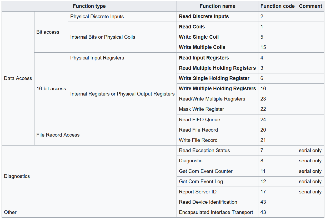

The master device sends a message to the first temperature sensor asking for the current temperature. The message includes the address of the sensor (1), the function code for “read holding registers” (which corresponds to a numerical code, in this case, 03), and the specific address of the register that contains the temperature data.
The temperature sensor receives the message and checks the address to ensure it’s the intended recipient. If the address matches its own, it continues processing the message.
The sensor then checks the function code to determine what action to take. In this case, the function code requests a read of a holding register. The sensor then reads the register specified in the message.
