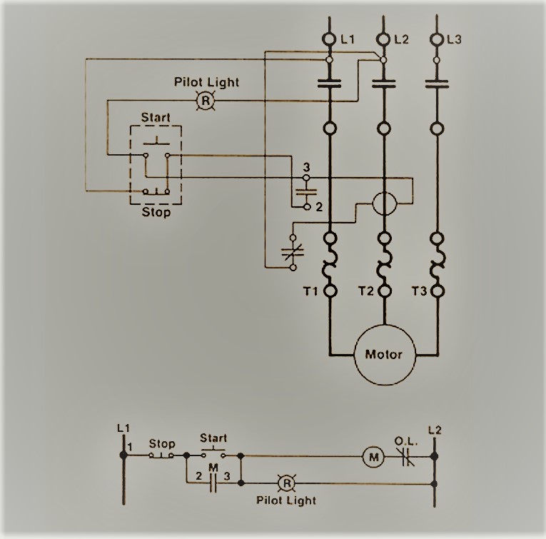

Below is the method of the Motor control functional test
set the isolator of the RCU in the field to open position
remove the lock out tag out (LOTO), then rack in the feeder and close the isolator on the draw-out unit.
measure the incoming voltage, check the phase sequence of the incoming power at field
Open the isolator at draw-out unit
Closed the isolator at the RCU
Closed the isolator at the draw-out unit
initiate start at the substation
verify the rotation of the motor, if the rotation is correct direction
then verify the running signal of the motor if it is link to DCS
initiate trip at the substation draw-out unit
verify the status of the motor at the field as well as in the DCS
reset trip at substation draw-out unit
verify again the status in DCS
initiate start in the field (RCU)
verify the status at DCS, if confirmed running signal
then stop the motor at RCU and verify the status in DCS if confirmed
Open the isolator in substation draw-unit and rack out
Put Lock out tag out (LOTO)
Test complete
