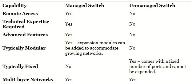

- A Managed Switch allows LAN traffic to be controlled and prioritized through configuration changes whereas an unmanaged switch is manufactured with a standard configuration that cannot be changed.
- Managed switches provide the tools to monitor, configure and essentially assist with improving network performance for a consistent, stable network.
Cost Difference Between a Managed and Unmanaged Switch
- Managed switches cost more than unmanaged switches because they typically have better technical specifications, advanced features that allow for user management and configuration, as well as VLANs (Virtual Local Area Network).
- Smart switches (lighter managed switches) would be more expensive than unmanaged switches but less expensive than the fully managed switches.

Difference between a Managed and Unmanaged Switch
