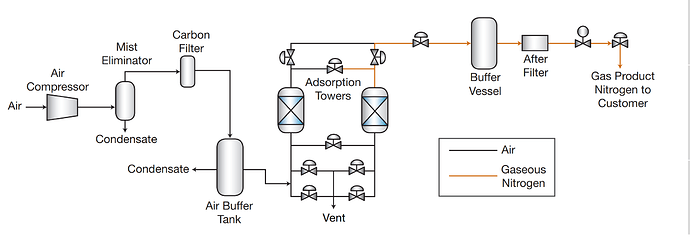

Nitrogen-PSA Plant
Typical applications
Because nitrogen generated by PSA generally contains small amounts of oxygen, some types of chemical processes lend themselves better than others to this type of supply.

Consequently, the manufacturer installed a nitrogen purge system to reduce the oxygen content in the tanks to a nonflammable level of no more than 2.5%. A PSA system that produced nitrogen containing 2% oxygen was combined with an inerting system to achieve a
safe operating atmosphere.

amounts of oxygen present in an inert nitrogen atmosphere. For these applications, if the nitrogen is delivered as a liquid and then vaporized, some amount of air must be blended with the high-purity nitrogen to achieve the desired oxygen concentration. However, PSA nitrogen generators are a more economical and convenient alternative, as they provide nitrogen with a small oxygen content.
One manufacturer’s process involved the storage and handling of monomers prior to free-radical polymerization. Monomer vapors are highly flammable and require an inert atmosphere in the storage headspace to prevent a safety hazard. The monomers contained hydroquinone as an inhibitor to prevent premature polymerization during storage.
To keep the hydroquinone active and to ensure the safe handling of the materials, a small volume of oxygen was required in the inert nitrogen gas. Two options could provide an inerting atmosphere with 2–4% oxygen: use liquid nitrogen, continuously blending it with oxygen, or install a PSA unit to provide a nitrogen product with the necessary oxygen level. The manufacturer selected a PSA system, which produced the required atmosphere and eliminated the additional blending steps.

Because of the application’s purity and pattern requirements, a VCM manufacturer installed an inerting system with nitrogen supplied by a PSA unit, which provides 99.5% nitrogen.
