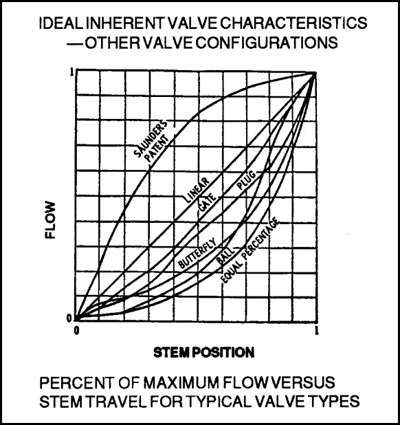

They have intermediate flow characteristics, the curve lies between linear & quick opening curves.
On/off valves shuts off the flow and remains tight in the flow direction. They offer great tightness when closed and a low flow resistance in the open position.
They doesn’t fully open or fully close. The data sheet might have shown a particular region of operation over the curve where valve is operating.
Examples of on/off valve includes ball, gate, butterfly & flow characteristics mentioned below:
What your co-worker meant to say by the open/ close valve is that it operates only at two discrete stages 0% or 100%, basically all the valves are analogus you can’t compare to it’s digital operation.
It will be more clear if you specify which valve you are using.

I would like to repeat again that on/off doesn’t mean they will have digital flow characteristics (0% & 100%), they are operated in open & close positions as described below.
On/off means to say that they are able to provide tight shutoff despite of flow direction. The flow characteristics of your CV will lie between linear & quick opening.
You can’t compare analogus nature of valve characteristics with it’s digital output.

Control Valve Flow Characteristics is the relationship between the percentage of valve opening on the flow rate.
So Basically, Every valve type has flow characteristics either it is control valve or on-off valve.
