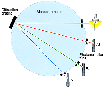

The clean sample is mounted in the stand and a spark is generated between the sample and a tungsten electrode. An example of this setup is illustrated in Figure 1. High purity argon is used as a discharge atmosphere to prevent any interaction between the atmosphere and the sample surface.
The material is violated from the surface of the sample resulting in the emission of light. When atoms are excited by an external energy source, some electrons move into higher energy levels. As these electrons drop back to their original levels, the atoms emit light (photons) of characteristic wavelength. The spectrometer collects the light emitted from the sample and splits it into its component wavelengths using a diffraction grating.
Fixed detectors (photo multiplier tubes in above figure) simultaneously measure light intensity at wavelengths characteristic of each element. This is illustrated in Figure above. The intensity of the signals depends on the number of photons produced per unit time. The spectrometer is programmed for fixed sample types, elements and concentration ranges and only give results within the limits of calibration .
