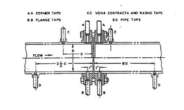

Orifice taps
There are 4 common arrangements of pressure taps:
  • Flange taps: Flange taps are the most popular because the distance from the orifice plate is precisely controlled
  • vena contracta: located to obtain the maximum differential pressure across the orifice
  • corner taps L located at each side of the orifice plate and are good for pressure measurement in pipes less than 50 mm diameter
  • Pipe taps: To measure the permanent loss of pressure across an orifice

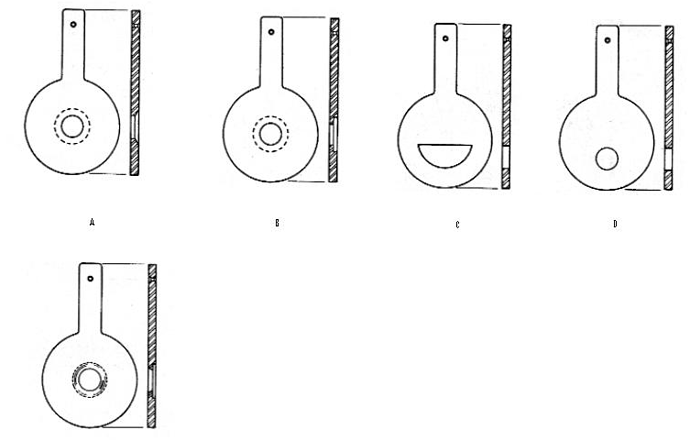

Special shaped orifices
For special applications there are several special-shaped orifices. The quadrant edge (quarter cicle) orifice is used at reynold numbers below which the square edge concentric orifice coefficient becomes too nonlinear. A conic entrance orifice can also be used for a similar range of reynolds number
Eccentric, segmental, and annular orifice are special devices to take care of dirty fluids and two-phase flows, but give bad accuracies (2%)
Fig 2. A.Bore and Bevel orifice B. Bore and counter bore C. Segmental D. Eccentric. E. Quarter-Round
