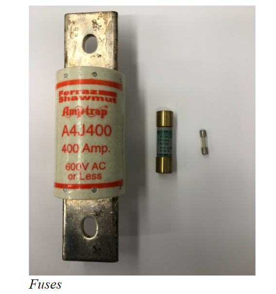

Fuses
A fuse is a simple device that protects the conductors and equipment of a circuit from damage due to higher than normal fault values. It is designed to be the weakest link in a circuit.
A fuse is an insulated tube containing a strip of conductive metal (fuse-link) that has a lower melting point than either copper or aluminum. The fuse link has narrow, resistive segments that concentrate the current and cause the temperature at those points to rise.
In a short circuit, the fuse elements burn open in just a fraction of a second. The higher the values of fault current, the faster the fuse will react.
In an overload situation, the fuse elements can take many seconds or even minutes before thermal actions cause the fuse link to melt open.
Fuses come in two categories: Fast-acting fuse (Type P) and time-delay fuse (Type D).
Fuses used in motor circuits have to withstand the intense inrush current when the motor is started, and so we use time-delay fuses, also known as “dual-element fuses.”
