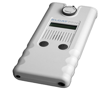

The Vasoquant 1000 is a 1-channel-photoplethysmograph that is used for venous function diagnosis.

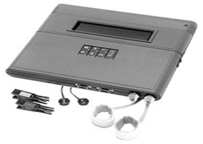

The Vasoquant 2000 is a 2 channeled photoplethysmograph provides diagnosis for venous and acral arterial functions.
