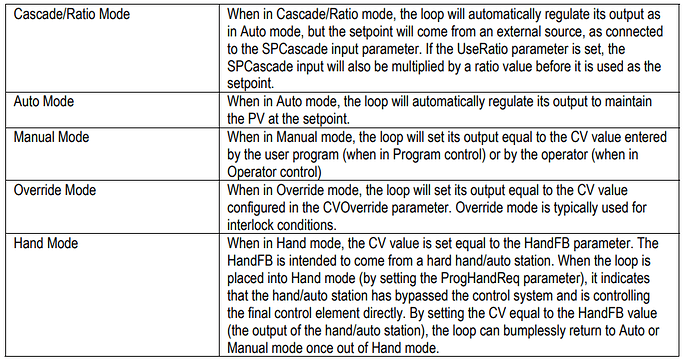

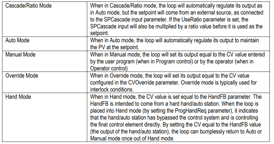

PID Controller Modes
Every PID controller can be operated in different modes like AUTO, MANUAL, CASCADE etc.
Some of the modes can be selected by the operator and some can be configured from engineering systems.
Common PID controller modes are :-
