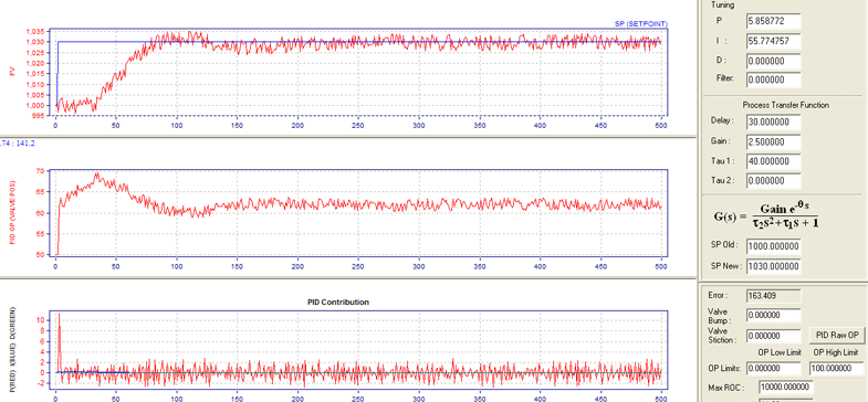

Figure 1 shows the PID main simulation screen. Many important process control parameters can be accessed from a single screen. This software PID has a very convenient and easy user interface.
