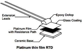

The thin film style of RTD is probably the most popular design because of their rugged design and low cost.
The thin film element is manufactured by coating a small ceramic chip with a very thin (.0001”) film of platinum and then laser cutting or chemical etching a resistance path in the platinum film.
The element is then coated with a thin layer of glass to protect it from harmful chemicals and gases.
Larger extension lead wires are spot welded to the chip and this junction is then covered with a drop of epoxy to help hold the wires to the element.
