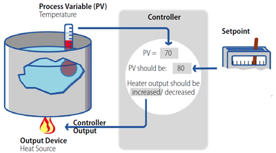

A PID loop could be used to control the temperature of a manufacturing process, for example. Historically PLCs were usually configured with only a few analog control loops; where processes required hundreds or thousands of loops, a distributed control system (DCS) would instead be used. As PLCs have become more powerful, the boundary between DCS and PLC applications has become less distinct.

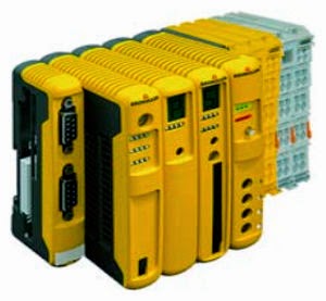

In recent years “Safety” PLCs have started to become popular, either as standalone models (Pilz PNOZ Multi, Sick etc.) or as functionality and safety-rated hardware added to existing controller architectures (Allen Bradley Guard logix, Siemens F-series etc.). These differ from conventional PLC types as being suitable for use in safety-critical applications for which PLCs have traditionally been supplemented with hard-wired safety relays.
For example, a Safety PLC might be used to control access to a robot cell with trapped-key access, or perhaps to manage the shutdown response to an emergency stop on a conveyor production line. Such PLCs typically have a restricted regular instruction set augmented with safety-specific instructions designed to interface with emergency stops, light screens and so forth. The flexibility that such systems offer has resulted in rapid growth of demand for these controllers.

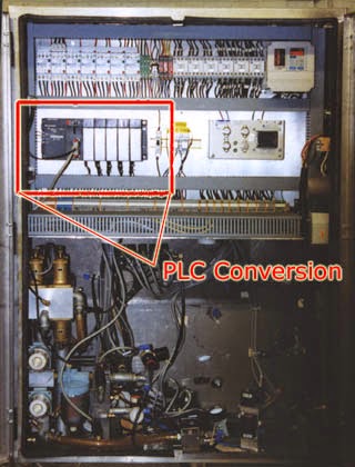

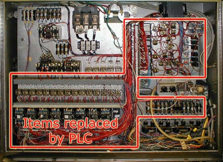

PLCS VERSUS RELAY CONTROL:
When deciding whether to use a PLC-based system or a hard-wired relay based system, one must ask several questions. Some of these questions are:
Is there a need for flexibile changes in control logic? Will there be a need for rapid modification? If yes, a PLC is more suited as it can be re-programmed on the spot. But if changes are not likely to be required, a relay system may be better, subject to other conditions listed below.
Is there a need for high reliability? In general, it is easy to maintain PLCs as they do not have mechanical parts that a electromagnetic relay based system has. So they have longer life. Secondly, PLCs have diagnostics and it is easy to replace the faulty unit as a whole. But a relay system for a complex logic is usually very difficult to troubleshoot. This is because it may not be obvious as to which part is malfunctioning.
Are space requirements important? PLCs save space and this is more true with more complex logic.
Are advanced, intelligent controls required? If so, PLCs are better.
Must similar control logic be used on different machines? If the volume of machines is very large, it may be cheaper to develop dedicated control systems like embedded microcontroller based systems.
Will the additional functionality provided by PLCs like communication, displays, memory be useful?
The merits of PLC systems make them especially suitable for applications in which the above requirements are particularly important. If the system was implemented using electromechanical relays (standard and timing), it would have made the control panel a maze of large bundles of wires and interconnections! If the system requirements need flexibility or future growth, a programmable controller’s advantages outweighs any initial cost advantage of a relay control system.
Even in a case where no flexibility or future expansion is required, a large system can benefit tremendously from the troubleshooting and maintenance aids provided by a PLC. The extremely short cycle (scan) time of a PLC allows the productivity of machines that were previously under electromechanical control to increase considerably. Also, although relay control may cost less initially, this advantage is lost if production downtime due to failures is high.

PLCs may include logic for single-variable feedback analog control loop, a “proportional, integral, derivative” or “PID controller.” A PID loop could be used to control the temperature of a manufacturing process, for example. Historically PLCs were usually configured with only a few analog control loops; where processes required hundreds or thousands of loops, a distributed control system (DCS) would instead be used. However, as PLCs have become more powerful, the boundary between DCS and PLC applications has become less clear-cut.
