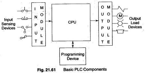

A typical PLC can be divided into three sections as illustrated in Fig. 21.61. These sections are the input/output (I/O) section, Central Processing Unit (CPU) and the programming device.

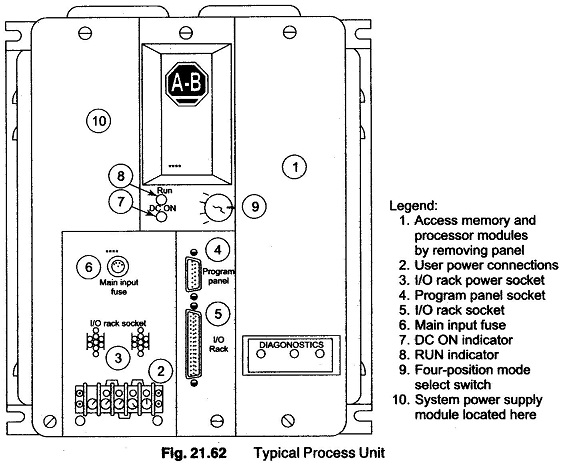

The CPU is the important section of a PLC and is the brain of the system. It contains internally a number of logic gates. The CPU shown in Fig. 21.62 is a microprocessor based system that replaces control relays, counters, timers and sequencers. It is designed so that the user can enter the desired circuits in relay ladder logic. The CPU accepts (reads) input data from various sensing devices, executes the stored user program from memory and sends the appropriate output commands to control devices.
A dc Power source is required to produce dc low level voltage used by the processor and the I/O modules. This power supply can be housed in the CPU unit or may be a separately mounted unit depending on the PLC manufacturer.
The I/O section consists of input modules and output modular. The 1/0 forms the interface by which field devices are connected to the controller. The purpose of this interface is to condition the various signals received from or sent to external field devices. Input devices such as Push Button, limit switches, sensors, selector switches and thumb wheel switches are hard wired to the terminals on the input modules.
Output devices such as small motors, motor starters, solenoid valves and indicator lamps are hard wired to the terminals on the output modules. These devices are referred to as field or real world inputs and outputs.
