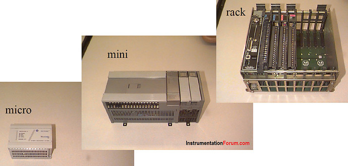

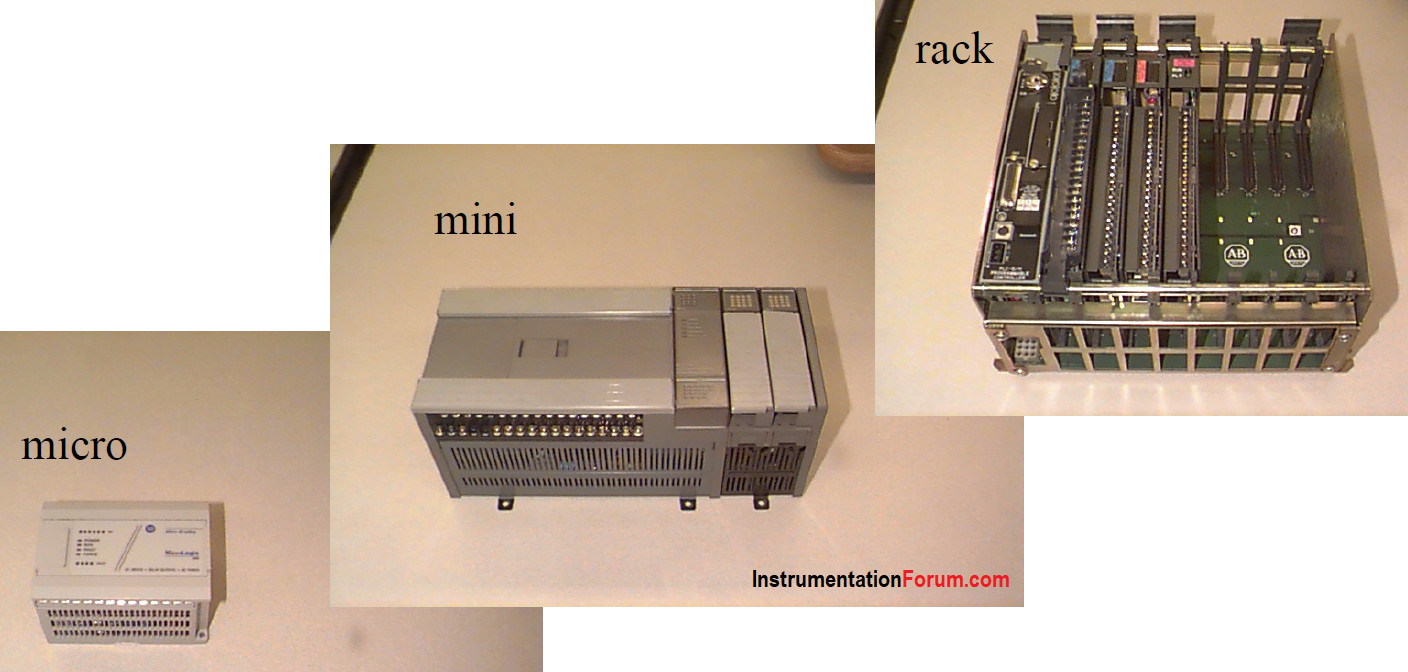

Configuration of the PLC
The configuration of the PLC refers to the packaging of the components.
Typical configurations are listed below from largest to smallest as shown in below Figure.
Rack
A rack is often large (up to 18” by 30” by 10”) and can hold multiple cards. When necessary, multiple racks can be connected together. These tend to be the highest cost, but also the most flexible and easy to maintain.
Mini
These are smaller than full sized PLC racks, but can have the same IO capacity.
Micro
These units can be as small as a deck of cards. They tend to have fixed quantities of I/O and limited abilities, but costs will be the lowest.
Software
A software based PLC requires a computer with an interface card, but allows the PLC to be connected to sensors and other PLCs across a network.
