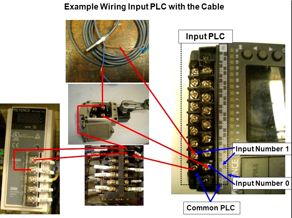

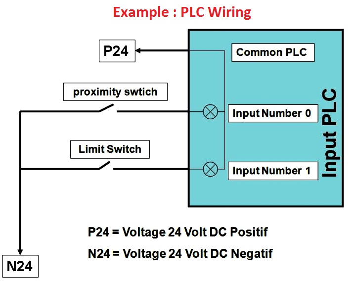

Example of wiring diagram for part of input PLC, Input PLC applied is limit switch and proximity swtich, while PLC applied by PLC Keyence.
Source of Voltage for input to PLC applies source of Voltage DC 24 Volt.
Example Of Wiring diagram PLC following way tacking on the cable.
