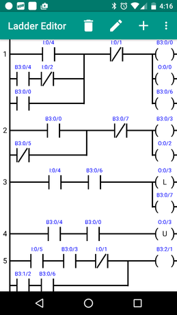

The Ladder Editor
The Ladder Editor is used to create your ladder-logic diagrams. There are tools to add, edit, and delete objects. The component library has 44 objects, such as a rung, a sub-rung, a normally open contact, a normally closed contact, a counter, a timer, etc.
Every rung will have a coil as its output. When a rung is added, the coil is added automatically. You choose the output variable that will be associated with that coil.
To add a contact, you must first have added a rung or a sub-rung upon which to add that contact. After indicating that you want to add a contact, you touch the rung or sub-rung to which you want to add it.

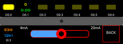

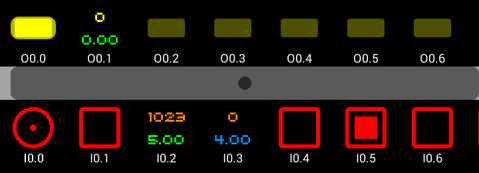

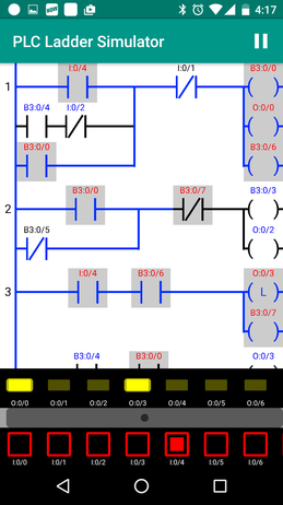

PLC I/O Interface
The PLC I/O Interface appears when the ladder-logic diagram is simulated on your Android device. The ladder-logic diagram appears on the upper part of the screen, the PLC I/O Interface below it. It has in its upper part indicator lights that represent the PLCs output coils. They turn yellow when the associated coil is high. Below them is the row of PLC inputs. You interact with your PLC simulation by pressing the switches or buttons that form the inputs.
If there are more inputs or outputs than can be displayed on the screen, you can slide them back and forth with your finger to see them.
It is also possible to have analog inputs, that is variables with values other than just high and low. Values for these can be set by touching them and then sliding the slider bar that appears. ​

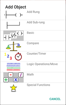

BASIC OBJECTS OF THE LADDER EDITOR
The Ladder Editor has 44 components that may be used to construct ladder-logic diagrams.
