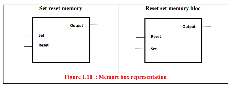

Both set coil and reset coil can be combined in one box as shown in Figure 1.10. Following

Set and reset functions are combined in one memory box as shown in Figure 1.10.
They can be further classified into two categories
a) Memory box with set priority b) Memory box with reset priority
The functions of a memory box are similar to the memory coils. In the memory box with set priority, the associated memory address is set when signal state 1 appears simultaneously at both the set and reset inputs. In the memory box with reset priority, the associated memory address is reset when signal state 1 appears simultaneously at both reset and set inputs. This concept is similar to Dominant ON and Dominant OFF functions of electrical latching circuits.
