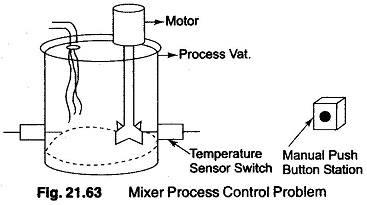

To understand the PLC Operation, consider the simple process shown in Fig. 21.63 In this process a mixer motor is to be used to automatically stir the liquid in a vat when the temperature and pressure reach a preset values. In addition, direct manual operation is also provided by means of a separate push button. The process is monitored with temperature and pressure sensor switches that close their respective contacts when conditions reach their preset values.
This control problem can be solved using the relay method for motor control shown in the relay diagram Fig. 21.64 (a)
The motor starter coil (M) is energized when both the pressure and temperature switches are closed or when the manual push button is pressed.

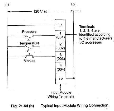

To use a PLC Operation for this process the same input field devices such as pressure switch, temperature switch and push button are used. These devices are to be hard wired to an appropriate input module according to the manufacturers labeling scheme. Typical wiring connections for a 120V AC input module are shown in Fig. 21.64(b).
