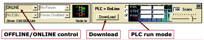

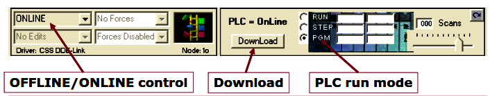

The ladder logic program is executed by going online, ‘downloading’ the PLC program, and switching to run mode.
