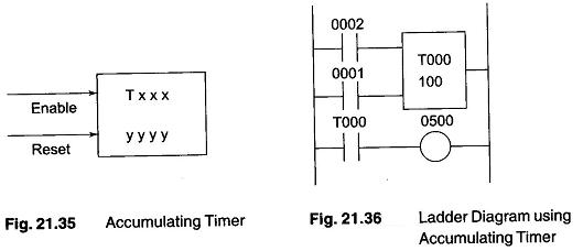

An accumulating timers, is as shown in Fig. 21.35. Let this timers be named Txxx. When the enable input is ON the timer starts to tick. When it ticks yyyy (the preset value) times, it will turn on its contacts that is used later in the program. The duration of a tick (increment) varies with the user and the timebase used. (A tick can be a 1 ms or 1 sec or …) If however the enable input turns off before the timers has completed, the current value will be retained. When the input turns back on, the timer will continue from where it left off. The only way to force the timers back to its preset value to start again is to turn on the reset input.
A ladder diagram is shown in Fig. 21.36 consisting of the symbol of the timer. When the input 0002 turns on, the Timer T000 (a 10 ms increment timers in this case) starts ticking. It will tick 100 times. Each tick or increment is 10 ms so the time will be a 100 x 10 ms = 1000 ms = 1 second timers. When 1 second is elapsed, the T000 contacts closes, output 0500 turns on. If input 0002 turns back OFF, the current elapsed time will be retained. When the 0002 turns back on, the timer will continue when it left off. When input 0001 turns on (true) the timers T000 will reset back to 0 causing its contacts to turn off (false) thereby making output 0500 turn back off.

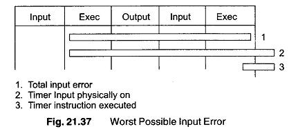

Input Errors: An input error occurs depending upon when the timers input turns on during the scan cycle. When the input turns on immediately after the PLC looks at the status of the inputs during the scan cycles, the input error will be at its largest (i.e. More than 1 full scan time). This is because as seen in the scan time, the inputs are looked at once during a scan. If it was not on when the PLC looked or scanned and turns on later in the scan, obviously an error would occur. Further, we have to wait until the timers instruction is executed during the program part of the scan. If the timer instructions is the last on the rung then the error could be quite large.

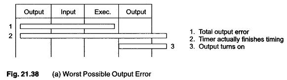

Output Error: An output error occurs depending upon, when in the ladder the timers actually ‘times out’ (ceases) and when the PLC finishes executing the program to get to the part of the scan when it updates the output. This is because the timers finishes during the program execution but the PLC must first finish executing the remainder of the program before it can turn on the appropriate output.
Figure 21.37 illustrates the worst possible input error.
- Total input error
- Timers input physically on
- Timers instruction executed
As seen from the Fig. 21.37, the worst possible input error would be 1 complete scan time + 1 program execution time. (A program execution time varies from program to program.)
Figure 21.38 (a) illustrates the worst possible output error. Again the worst possible output error can be 1 complete scan time.
Based on the figure, we can see that the total worst possible timers error would be equal to : 1 scan time + 1 program execution time + 1 scan time = 2 scan times + 1 program execution time.
