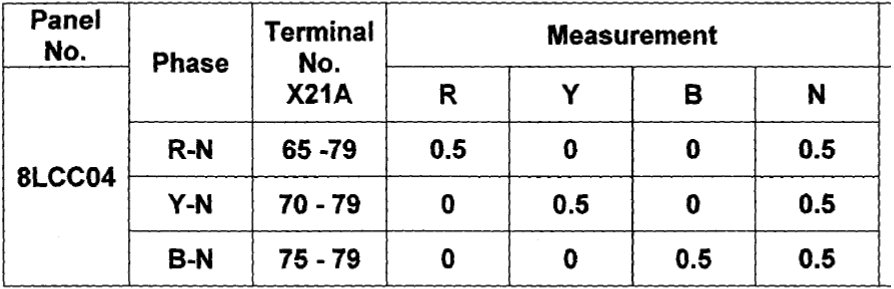

Please see attached, and inform what we are doing?
A. Phase to Phase Primary CT injection
B. Phase to Neutral Primary CT injection
C. Phase to Phase Secondary CT injection
D. Phase to Neutral Secondary CT injection
Answer: D
