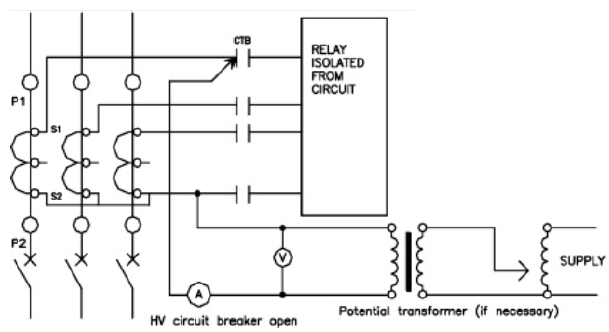

Please see the figure and inform what is the connection below?
Please see figure and inform what we are doing?
Excitation Test
A. Excitation Test of CT
B. Burden Test of CT
C. Secondary winding resistance measurement
D. Polarity Test
Answer: A
