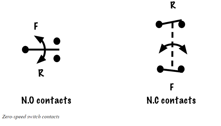

If the sudden reversal of a motor is considered undesirable, then our control circuit can be designed to provide anti-plugging, which can be provided by either a normally closed zero-speed switch or off-delay timer relays.
As a general rule, the control scheme for plugging includes a reversing magnetic starter and a rotary-motion switch called a zero-speed switch. The switch assembly is usually connected directly to the shaft of the motor or the driven equipment so that when the motor spins in a particular direction, the contacts change their state (normally closed contacts open, and normally open contacts close).
Normally open contacts provide plugging while normally closed contacts provide anti-plugging.
