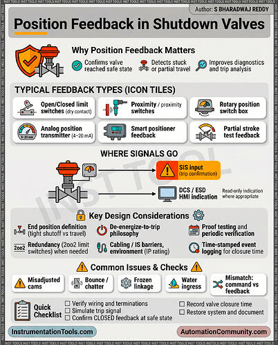

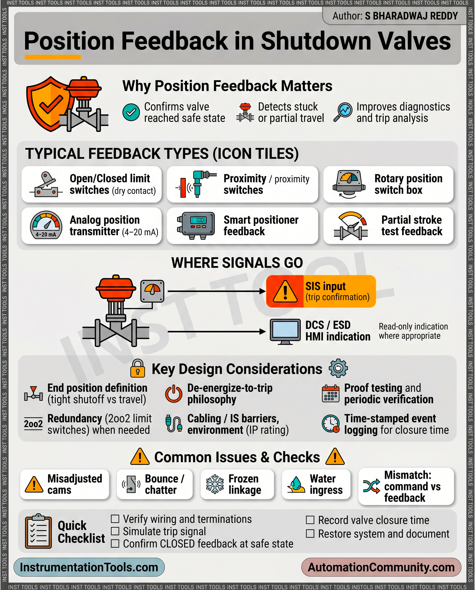

Position Feedback in Shutdown Valves
A shutdown valve is not considered safe just because a command was sent…
The real question is :backhand_index_pointing_down:
:backhand_index_pointing_right: Did the valve actually move to the required position?
:gear: What is Position Feedback?
:right_arrow: A signal that confirms the actual valve position
:right_arrow: Verifies whether the shutdown valve is:
:small_blue_diamond: Fully Open
:small_blue_diamond: Fully Closed
:small_blue_diamond: In Transit
:brain: Why is it important?
Sending a shutdown command is one thing…
:white_check_mark: Confirming valve closure is another.
A failed valve can leave the process exposed even though the SIS issued a trip command.
:rocket: How position feedback is obtained
:small_blue_diamond: Limit switches
:small_blue_diamond: Proximity switches
:small_blue_diamond: Valve position transmitters
:small_blue_diamond: Smart valve positioners
:factory: Typical Shutdown Sequence
:fire: Hazard detected
:down_arrow:
:shield: SIS issues trip command
:down_arrow:
:gear: Shutdown valve moves
:down_arrow:
:satellite_antenna: Position feedback confirms closure
:down_arrow:
:white_check_mark: Safety action verified
:warning: Without position feedback
:cross_mark: Valve stuck open
:cross_mark: Mechanical failure unnoticed
:cross_mark: Air supply failure undetected
:cross_mark: False assumption of protection
:magnifying_glass_tilted_left: What operators monitor
:green_circle: Valve Open Confirmation
:red_circle: Valve Closed Confirmation
:warning: Valve Travel Timeout Alarm
:warning: Valve Not in Required Position Alarm
:test_tube: Role during Proof Testing
Position feedback helps verify:
:white_check_mark: Valve stroke completed
:white_check_mark: Final element is healthy
:white_check_mark: Safety function is working correctly
:bullseye: Key takeaway
:backhand_index_pointing_right: Commanding a shutdown valve is not enough.
:backhand_index_pointing_right: The SIS must know the valve actually reached the safe position.
:stop_sign: Trip Command = “Close the valve”
:satellite_antenna: Position Feedback = “Valve successfully closed”
Both are required for a reliable Safety Instrumented Function (SIF).
