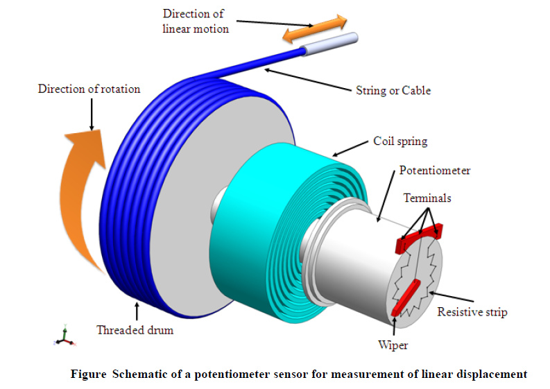

The Figure shows the construction of a rotary type potentiometer sensor employed to measure the linear displacement. The potentiometer can be of linear or angular type.
Potentiometer Sensor
It works on the principle of conversion of mechanical displacement into an electrical signal. The sensor has a resistive element and a sliding contact (wiper). The slider moves along this conductive body, acting as a movable electric contact.
The object of whose displacement is to be measured is connected to the slider by using
• a rotating shaft (for angular displacement)
• a moving rod (for linear displacement)
• a cable that is kept stretched during operation

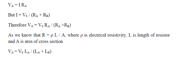

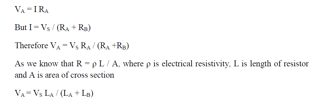

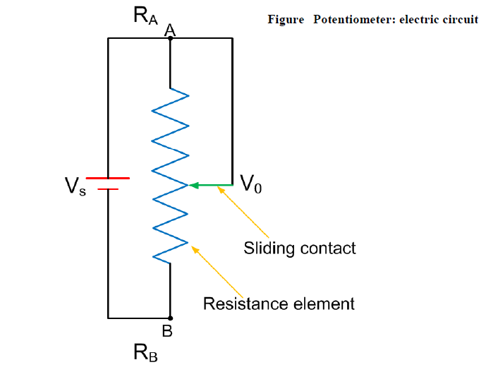

During the sensing operation, a voltage Vs is applied across the resistive element. A voltage divider circuit is formed when slider comes into contact with the wire. The output voltage (VA) is measured as shown in the below figure.
The output voltage is proportional to the displacement of the slider over the wire. Then the output parameter displacement is calibrated against the output voltage VA.
