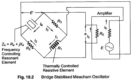

The bridge stabilised Meacham oscillator given in Fig. 19.2 is a constant frequency oscillator of very high stability.
It consists of a Wheatstone’s bridge and an amplifier section. One of the four bridge arms is a thermally controlled resistance element, two of the arms are fixed resistances, and the fourth is a frequency controlling sensitive element, i.e. crystal.
Because of the presence of a thermally sensitive element having a large positive temperature coefficient of resistance (a small tungsten filament lamp of low wattage rating), the output of the bridge is amplitude stabilised and relatively insensitive to small changes in circuit parameters and fluctuations in power supply.
