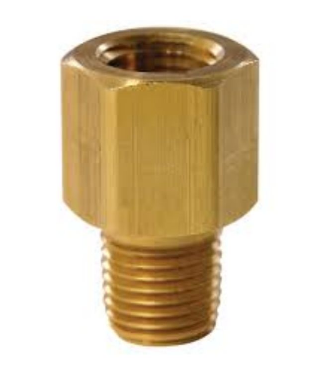

A pressure gauge snubber is a device used to suppress (“snub”) excess force or rapid movement in mechanical systems. Pressure snubbers are designed to dampen the effect of pressure pulses and spikes to assure longer service life and readability of pressure gauges in harsh applications. Offered in a choice of porous, piston or throttling designs; these units can handle a range of media, from air and other gases, to water, steam, gasoline and oils.
Pressure snubbers protect pressure gauges from the harmful effects of vibrations generated in a pressurized system with pulsations such as positive displacement pumps or compressors. The pressure snubber works by evening out pressure fluctuations. Snubbers do not alter the pressure of the process, but reduces the pulsation in the line, thereby improving the stability of the gauge reading, while extending the effective lifetime of the gauge.
A fluid filled gauge can achieve a similar result, but some pressure systems are so intensive that you need to install a snubber in addition. When one is interested in the measurement of fast, transient pressures (such as to initiate safety interlocks on rising pressures), snubbers should not be used, as they delay the response of the safety system.

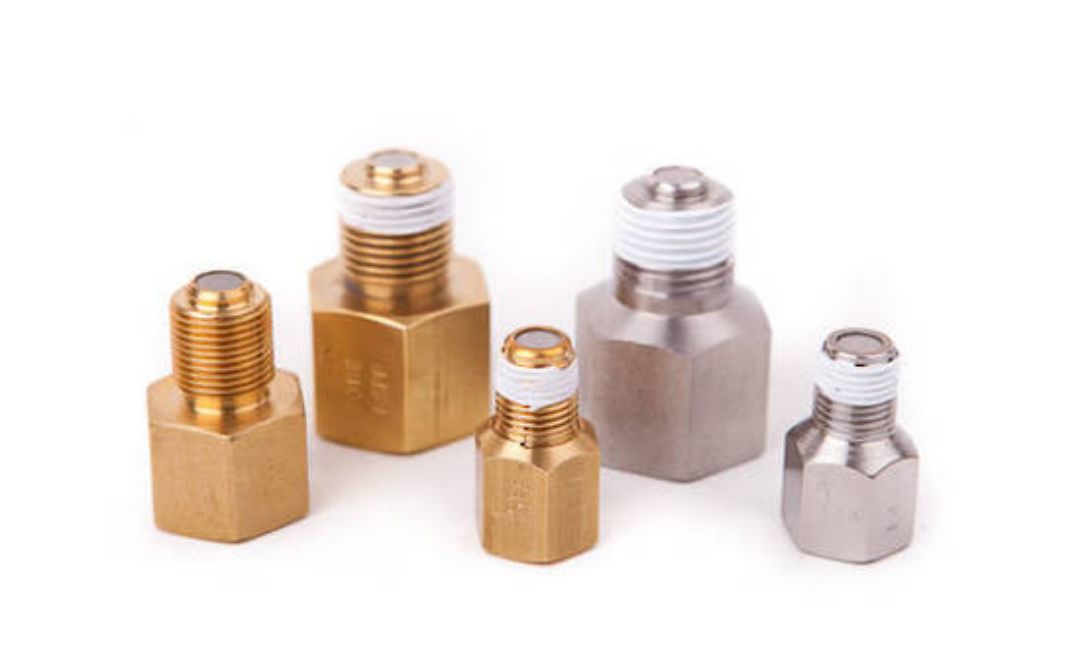

On the low-cost end of the snubber spectrum is the porous disc type (also known as a “filter type”). The fixed disc creates a semi-permeable barrier between the incoming pressure and the pressure gauge’s orifice. The pressure meets that disc and has its force distributed through the metal mesh, slowing it so that it will not harm the gauge. The pressure rises gradually, so that the gauge doesn’t jump a gear or burst a bourdon tube.
The porous disc design allows consistent pressure at low speeds, though, so that the gauge’s readings are not affected by the filtering material.
The downside of a porous disc snubber is that it can become clogged, depending on the process being measured. In that case, the readings would be affected and the snubber would have to be cleaned by flushing it from the gauge side with a solvent.
