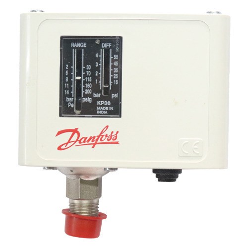

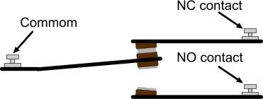

Pressure Switch has 3 contacts.
Common
NO (Normally Open)
NC (Normally Closed)

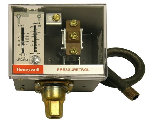

A spring is used in pressure switch when pressure increases this spring comes in tension. A pressure is also set using adjusting screw when increasing or decreasing pressure comes to this pressure contact changes from NC to NO or from NO to NC.
A differential pressure is also used In pressure Switch. In this pressure Switch, two Pressures are used.
1.Differential Pressure.
2.main Pressure.
Let Suppose main Pressure is 4kg/cm^2 and Differential Pressure is 1 kg/ cm^2, then on increasing pressure contact will change from NC to NO at 5 kg/cm^2 and on decreasing pressure from NO to NC at 3 kg/cm^2.
Pressure switch
The connection of a Pressure Switch
2 wires are connected in a pressure switch
One is connected in common and other is connected in NO or NC according to the application.
Pressure Switch Connections
