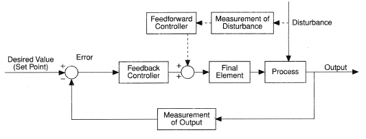

For example, in classical feedback control , one can correct for the effects of a disturbance by:
- measuring some property of the system to be controlled (its temperature, for example):
- comparing it with its desired value (set point) and calculating what changes, if any, are required as inputs to the process;
- making an appropriate adjustment to that/those inputs (a variable heater, for example).
Similarly, in feedforward control , one can anticipate and compensate for the effects of a major disturbance to the process by first measuring the disturbance; this would then be followed by the other two steps described above. Both feedback and feedforward control can be used on the same process as illustrated diagrammatically in [Figure 1]
Figure 1.
