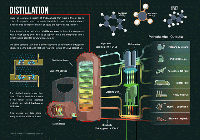

Once it enters the modern refinery, crude oil goes through a process called fractional distillation . This process separates the different components of crude oil so that they can be further refined. Fractional distillation begins when the crude oil, which is a mixture of different hydrocarbons, is put into a high-pressure steam boiler. This is a tank that makes the oil boil and turn to vapor, much like boiling water turns into water vapor. The crude oil is heated to temperatures up to 1112° Fahrenheit.
After the oil becomes vapor, it enters the bottom of the distillation column through a pipe. The distillation column is a tall tank that contains many plates or trays. The vapor rises in the column, cooling as it rises. The specific vapors cool at their boiling points and condense on the plates or trays in the column. Much like water condensation on the outside of a cold glass, the vapors turn into liquid fractions as they condense. The liquid fractions flow through pipes and are collected in separate tanks. The fractions include gases, naphtha, gasoline, kerosene, diesel fuel, lubricating oils, heavy oils, and other materials.
