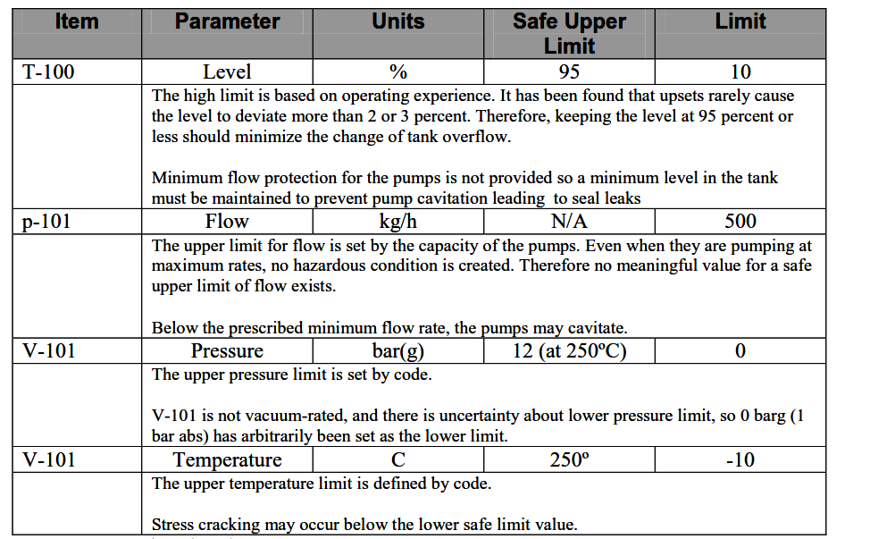

Table provides some examples for safe limit values for the equipment items in above figure. Table also provides some discussion to do with each value, showing where it came from, and what the impact of exceeding that value would be.

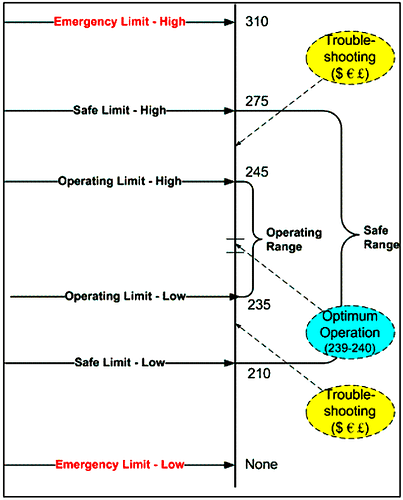

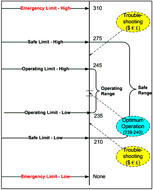

Above Figure provides another illustration of the safe limit concept (the values shown in figure could be for any process parameter such as pressure, temperature, level or flow).
Figure shows three ranges for the process parameter in question. The first is the normal operating range; it lies between 218 and 245 (in the appropriate units of measurement).
Normal operations are carried out within this envelope. If the value is allowed to go outside the range it is likely that production or quality problems will crop up. If an operating value goes outside the operating range, but stays within safe limits, then the facility is in “trouble”.
There is no perceived safety or environmental problem during this phase of the operation, but the facility may be losing money.
Examples of trouble in this context include
- excessive steam consumption
- product quality problems
- unusually high consumption of spare parts
- production flow limitation problems
Figure 59. Example of safe limit range
The second range lies between the safe upper limit and the safe lower limit (210 - 275 in figure 59). These parameters are sometimes referred to as “Not to Exceed” limits. If the value of the parameter goes outside this range then the process is, by definition, unsafe, and action must be taken.
The option of doing nothing is not an option. It is likely that, once these safe limits are breached, safety devices, particularly instrumentation systems, will be activated. Operations personnel should understand the consequence of exceeding the limits; they should also be provided with procedures and training as to what actions to take to bring the variable back into the safe range. If the operations team wishes to operate outside the safe range, say to increase production rates, they can only do so after implementing the management of change process.
The third range shown in figure 59 defines emergency conditions. If a variable value goes outside the emergency limit range, urgent action is required. It is probable that an excursion outside the safe limits will lead to activation of emergency instrumentation and mechanical safety devices, such as pressure relief valves. Some safe limits may have no meaningful value.
For example, if a pressure vessel is designed for full vacuum operation, then that vessel has no safe lower limit for pressure. In table 5, no value for a safe upper limit for high flow is provided because the system is safe even when the pumps are running flat-out with all control valves wide open.
