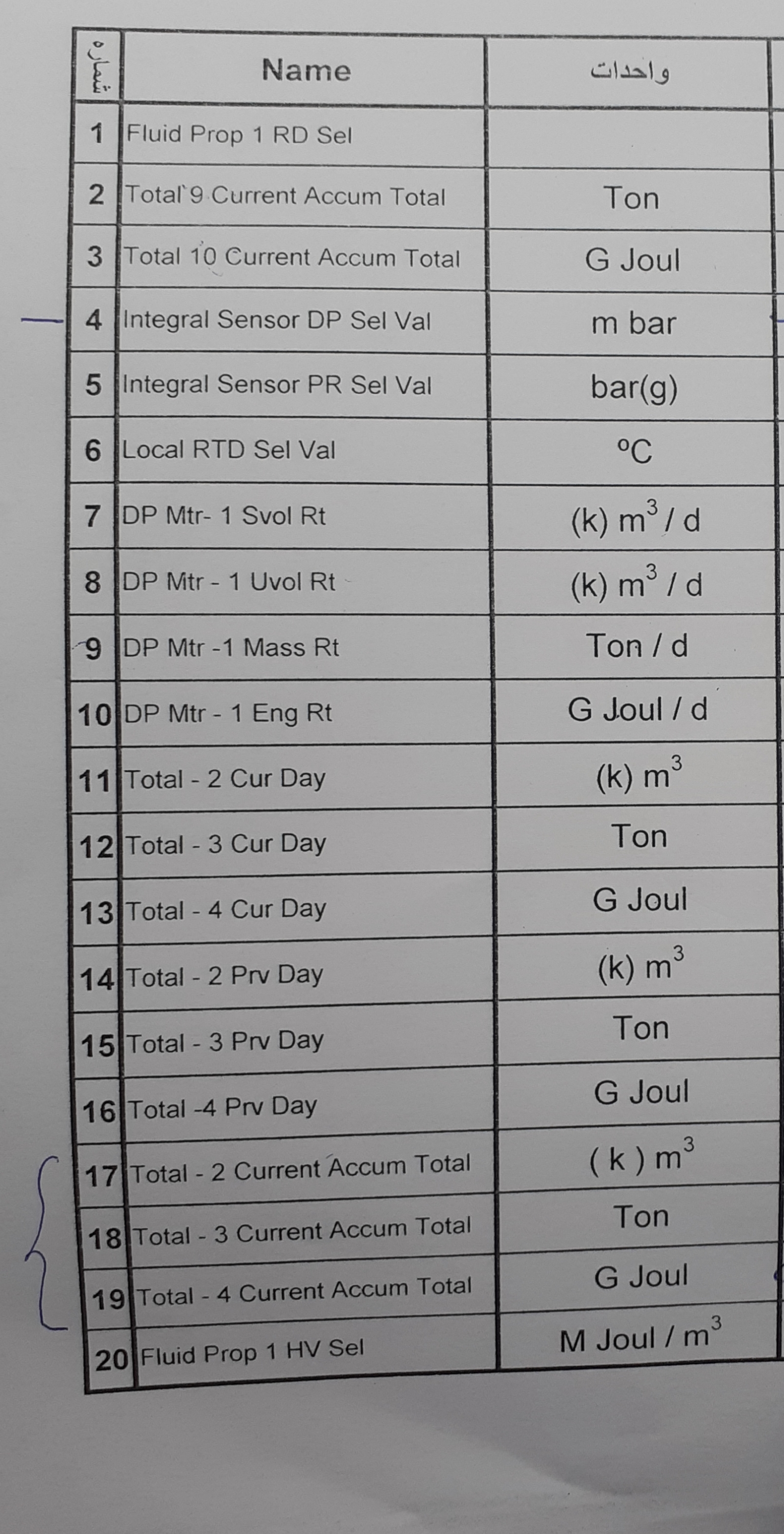

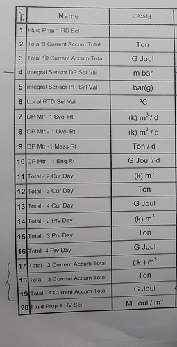

Please explain about regarding attached pic
Above parameters are in flow computer

u have to check on calculation which is done by FC
for this you have fix PTx TTx DPTx & GC data and verify calculation
