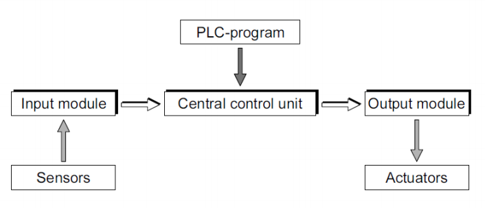

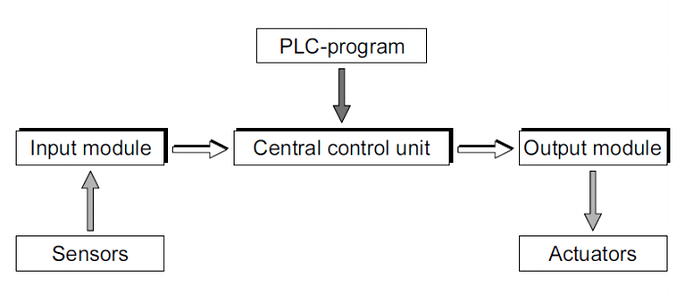

PLC Operation
The function of an input module is to convert incoming signals into signals that can be processed by the PLC, and to pass those signals to the central control unit. The reverse task is performed by an output module.
This converts the PLC signal into signals suitable to operate and invoke the plant actuators. The actual processing of the signals is undertaken in the central control unit and with respect to the program stored in the memory.
