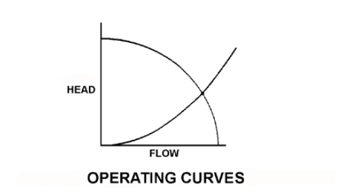

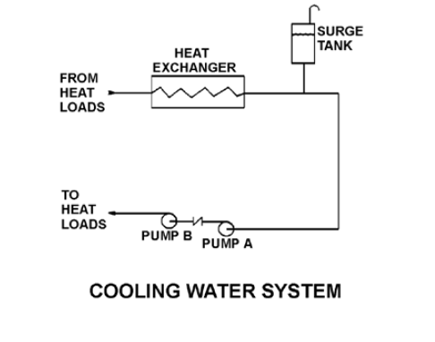

Pumps A and B are identical single-speed centrifugal pumps and both pumps are operating ___
Refer to the drawing of a cooling water system and the associated pump/system operating curves (see figure below).
cooling water system and the associated pump system operating curves -PG-94
cooling water system and the associated pump system operating curves -PG-94-2
Pumps A and B are identical single-speed centrifugal pumps and both pumps are operating.
If pump B trips, after the system stabilizes, system flow rate will be…
A. more than one-half the original flow.
B. one-half the original flow.
C. less than one-half the original flow.
D. the same; only the pump head will change.
Answer: A
