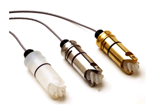

The turbine flow meters shown to the left are one form of this type of device. The cartridge unit is inserted into the flow stream with the shaft of the turbine unit parallel to the flow. This allows the flow across the angled turbine element to rotate in proportion to the flow across the blades. This device works well as long as the flow is not turbulent.
Since the meter is not actually measuring the full cross section of the flow, only the flow at a single point near the wall of the pipe, excessive turbulence will cause readings that are not representative of the real flow in the pipe.
