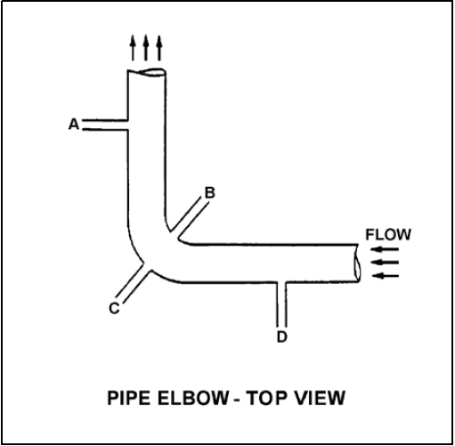

Refer to the drawing of a pipe elbow (top view) in an operating water system ___
Refer to the drawing of a pipe elbow (top view) in an operating water system (see figure below).
At which one of the following locations is the lowest pressure sensed?
(Assume a constant pipe diameter and zero head loss in this section of pipe.)
A. Point A
B. Point B
C. Point C
D. Point D
Answer:B
