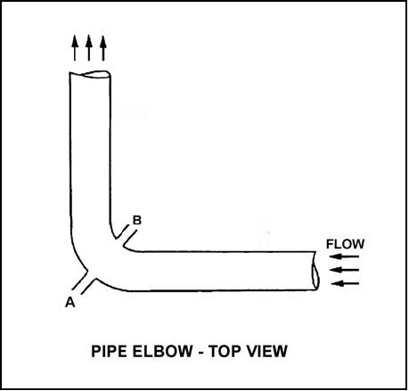

Refer to the drawing of a pipe elbow used for flow measurement in a cooling water system. A differential pressure (D/P) flow detector is connected to instrument lines A and B ___
Refer to the drawing of a pipe elbow used for flow measurement in a cooling water system (see figure below).
Pipe Elbow Top View-PG-35
A differential pressure (D/P) flow detector is connected to instrument lines A and B.
If instrument line B develops a leak, flow rate indication will __________ due to a __________ measured D/P.
A. increase; larger
B. increase; smaller
C. decrease; larger
D. decrease; smaller
Answer:A
