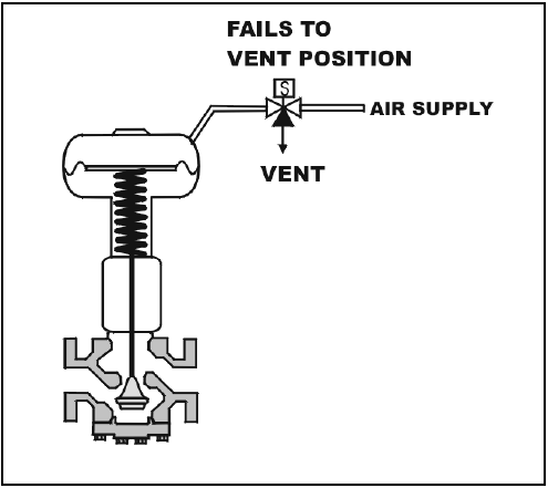

Refer to the drawing of a spring-loaded air-operated valve shown in a throttled position (see figure below).
Which one of the following will be the valve position following a reduction in air pressure to the valve actuator caused by a leaking air connection at the valve?
A. Original position
B. More closed
C. More open
D. Varies with system flow
Answer: B
